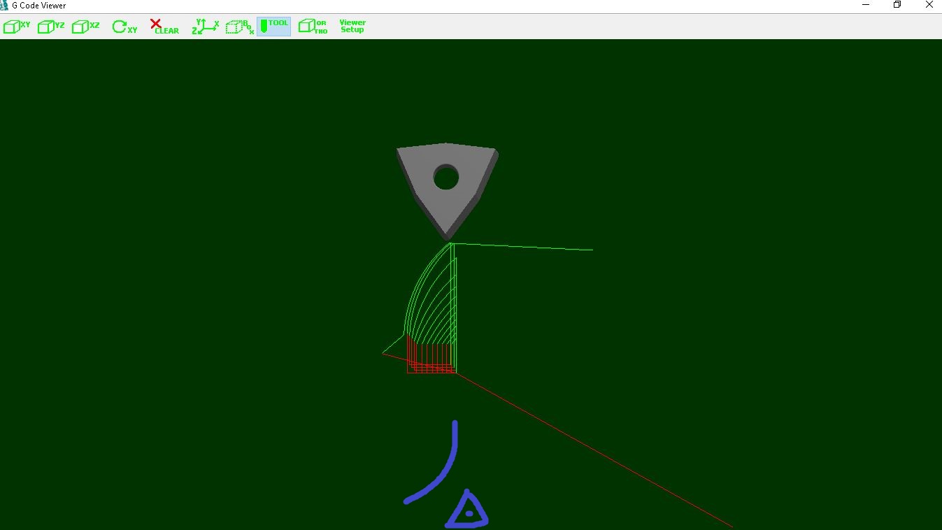

turbothis
Posts: 325
Joined: Fri Mar 15, 2019 4:07 pm
Location: southern oregon
Re: i got no G viewer
Post by turbothis » Tue Jan 16, 2024 9:36 pm
also i noticed my program is backwards. the blue is the correct arc and tool position.
i remember doing this years ago and for the life of me cant recall the settings for this
