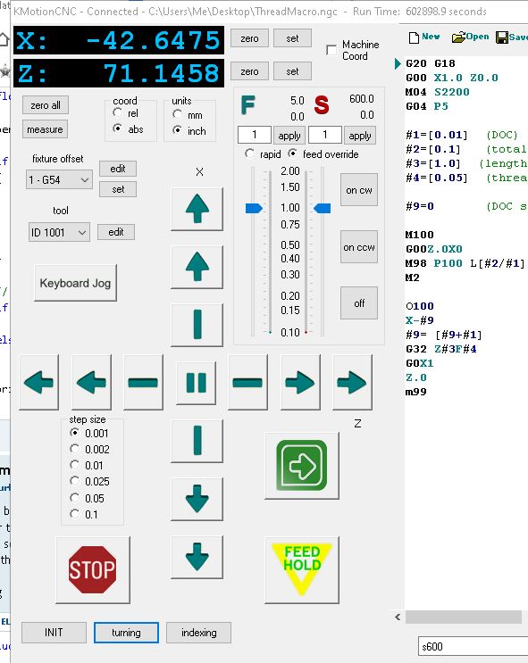

ok, i got the spindle servo mounted and ready to test run in jog mode. i just need the 5v and ground to the encoder
spindle encoder A/B to ch2
spindle Z to A4+ and A4- ( bits 8 and 9? )
i dont really under stand the SpindleOnJog examples as the 3 of them all seem to do something with ClearBit(154); ClearBit(155);
with using DAC output there is no need for any FET bit toggling right?

likely jumping the gun but wondering why i can "init" and have encoders read position zero and then when i push either turn or index button i get a new encoder position?
i mean neither index or turn have a set position type command in there right?
idk what is your Init Program doing? Post it. What are the Position values on the KMotion.exe Axis Screen?
