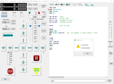

Post by turbothis » Fri Nov 17, 2023 8:54 pm
hmmm, did some manual Z axis tuning and are looking nice
i try and MDI command a 1" move to check for how close it will get but it gives me an error?
when i try and just "run" button my threading code i get the same but with white encoder counts.
not sure what is not complete?

my step increment buttons dont do any movement too?
jog does fine....
i bet i am about to be learned! :D

Re: simple 2 axis lathe initial lathe set up
Post by TomKerekes » Sat Nov 18, 2023 6:38 pm
Your Spindle Axis #2 should not be included in the Coordinate System.
Post your \KMotion\Data\GCodeConfigCNC.txt file or Tool Setup Screens so we can see your Configuration
