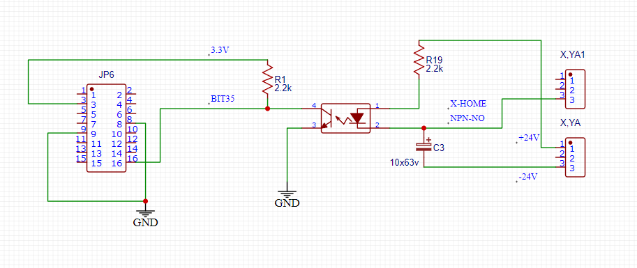

That's the first thing I thought Tom.Well if it works in the Digital IO Screen it should work in the C Program. One exception to this is that the Digital IO Screen only displays the status several times per second so if there are noise glitches on the signal they may not be displayed but the C Program will likely detect.
But why does it all work on Bit 7 Pin 14 ?
Here is the diagram. I just changed connector JP7 pin 14

Re: fpga(kan_trig_reg)
Hi Taras,
That circuit should work.
Does the state on the Digital IO Screen show it is working properly when connected to Bit35?
Bits 34 and 35 can be configured as a Step/Dir Generator #3 outputs. If so configured the pins can not be used as GPIO. The Step/Dir Mux bit would need to be set to 1 and an axis would need to be configured as Step/Dir with Output Channel 3 to cause a problem.
