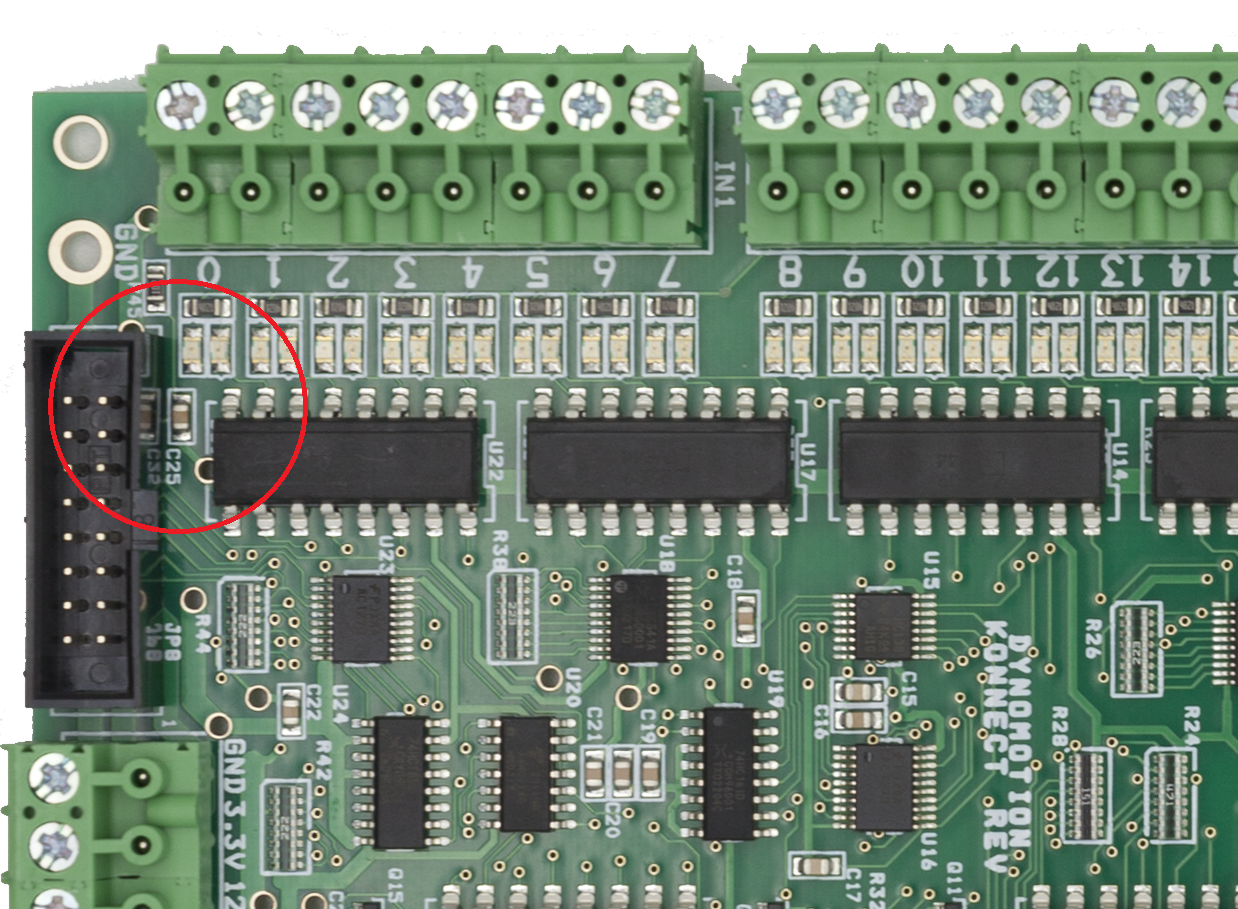

My apologies this is a known problem with Kogna and Konnect. The issue is the older Konnects place an excessive capacitance on the Reset signal. The ribbon cable inductance combined with the capacitance results in the Reset signal rising in a non-monotonic manner which causes the Ethernet Transceiver to not reset properly.
The solution is to remove C25 from Konnect. Our newer Konnects have C25 removed. I assume this is an older Konnect?
Can you remove this Capacitor? If not please ask for an RMA number and we will remove it for you.

C25 is populated on the Konnect board I am testing with.
I will go ahead and remove it (and I'll get some of the newer rev boards ordered).

Hi Tom - I just wanted to follow and let you know that I did remove C25 and that did correct the problem.
