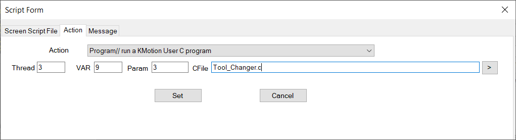

I'm trying to make custom buttons that will pass a parameter to my tool changer routine. While milling , the g-code command "M6 T1" will pass the "1" to my program without issue.
Now using the custom button , I was under the impression that the "param" box would be the value of the VAR but it doesn't seem to work.
I set the parameters to the Action function like on the picture, but when calling the tool changer, the value isn't passed properly and instead of "3" as in the example ,it seems to use an uninitiated value of -10000000. What am I doing wrong? Anyway I can pass a value (from 1 to 16) to the function using the action call?

The value is passed as a 32-bit float value and can be accessed with
Is that how you are accessing it ?
int Button = *(float *)&persist.UserData[PERSIST_VAR]; // button code pushed

You might read it assuming it is an integer set by M6 and if it is invalid then assume it is a float set by a button. Something like:
Note your original code assumes that Tool is a pointer to an integer. So its value is obtained by de-referencing the pointer with *Tool to get the value. But in the above code Tool is a simple integer so use Tool everywhere. A pointer is useful if you need to change the original value, but I doubt if that is ever required.
int Tool = persist.UserData[TOOL_VAR]; // assume integer
if (Tool <= 0 || Tool >= 10) // invalid Tool Number?
Tool = *(float *)&persist.UserData[TOOL_VAR]; // yes, must be float
printf("Tool : %d\n", Tool); // Displays value of the tool to change to (From M06 TXX g-code)
