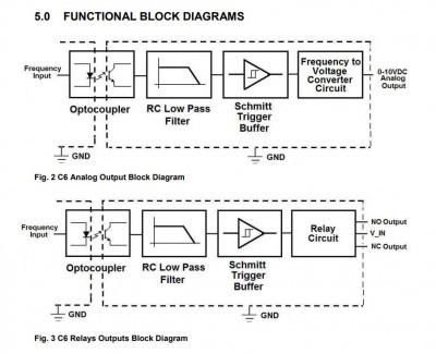

Next will be interfacing my Kflop with the inverter through a C6 interface board. There was a pretty good post on how to do that so I'll start there and see how far I get.

You might also use the IO on KStep which is fully isolated.Next will be interfacing my Kflop with the inverter through a C6 interface board. There was a pretty good post on how to do that so I'll start there and see how far I get.

Yes, I was going to use JP26 for CW/CCW and Speed

I have my spindle starting and stopping from Kflop JP5. When I switch to Kstep JP26 I get nothing. I read that I have to enable the amplifiers on Kstep. I have separate 5volt supplies for Kstep and Kflop. Do I connect a jumper from Kstep JP6 enable to Kstep 5v? Kstep Ground? or Kflop Ground?

How can you do this? KFLOP JP5 have Step/Dir LVTTL outputs. JP26 has no Step/Dir outputs and has relay driver outputs (basically switches). Totally different.I have my spindle starting and stopping from Kflop JP5. When I switch to Kstep JP26 I get nothing.
That's for the Stepper Motor Drivers not JP26 IO.I read that I have to enable the amplifiers on Kstep.

Well I guess that explains a few things. I saw Step and Dir on JP26 and assumed that I could use those points to drive my spindle. I misunderstood the documentation.
I've had separate power supplies since day one. The reason I mentioned it was so I didn't screw something up when trying to fire up the enable pin which is an non issue now since that won't work.
Kflop is connected to Kstep through JP7.
So back to an earlier response from you when I said I wanted to control a spindle you suggested "You might also use the IO on KStep which is fully isolated." Where/how would I do this? or should I just leave well enough alone and stick with JP5 (I/O 39,40 & 41)?
