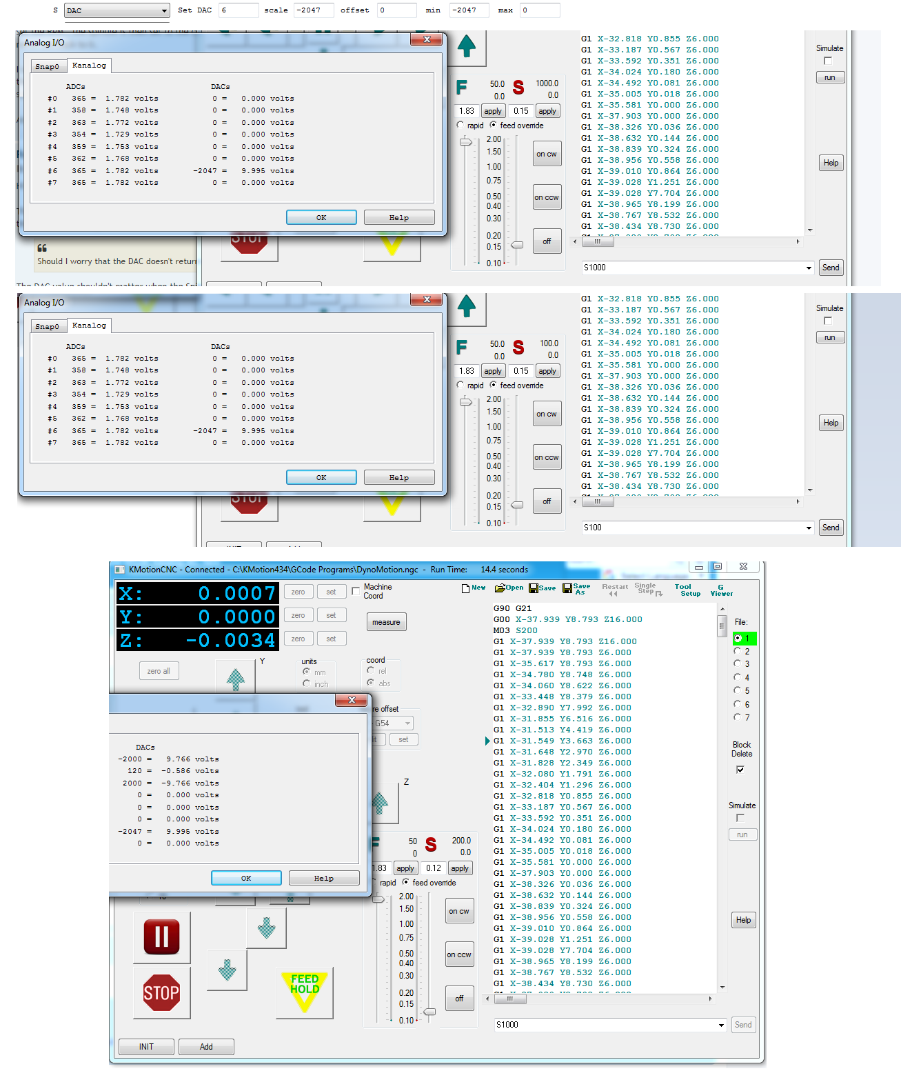

I did more tests with the SSO and still nothing changes. I took some screenshots and mashed up a picture for you. The very first line is how my S is setup in tool setup screen. Underneath is the S1000 command , S set to 1000 and the DAC value. Underneath is S100 command , but the DAC remains at the same value (-2047). Nothing I do here , lowering the slider to 0.15 and hitting apply , the DAC will never change value. (The spindle reacts properly when I manually set the DAC in the console). The last part is when Kflop is running the default GCode found in sheet 1. It sets the speed to 200 but the DAC doesn't change either. Using the override doesn't change anything.

Post by TomKerekes » Wed Dec 14, 2022 7:09 pm
Hi Roamin,
I think the issue is you have the Scale set at -2047. This means that a command of 1RPM the output will be -2047 (10V). Divide the -2047 by whatever speed your spindle runs when commanded to full 10V. For example if the full speed is 1000 RPM then the scale would be -2.047

Well.. I don't know what to say.. If only I took more time to read the documentation properly. I read and re-read the "Basic Configuration" paragraph a few times but I had not noticed the period in the scale.. My calculations were based on 1000 RPM but I just entered "-2047" instead of "-2.047". Although that paragraph doesn't mention dividing the scale by the RPM , it clearly states -2.047 .. -> "Note the S action is mapped to Kanalog DAC #7 with a negative scale of -2.047."

I confirm that adjusting the scale properly gives me control over the spindle speed with the slider.. :lol: :lol:
