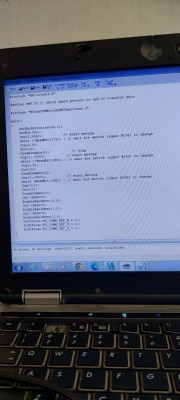

i have attached my homing program image below This is the image which contrains my DRO value and edit fixture offset screen after run that above program,
Ajith Arawinth.

I think one problem might be that after the Limit is detected the axis is Zeroed while still moving so by the time it stops it is no longer at Zero. Jog(axis, 0); commands the axis to stop, but it takes time to come to a stop. To wait till an axis is stopped you can use
while (!CheckDone(axis)) ;
The sequence should be
Jog to Limit
wait for limit
command to stop
wait til stopped
disable axis
Zero
If you still have problems post your Trajectory Planner settings and the KMotion Axis Screen Destinations after Homing.
