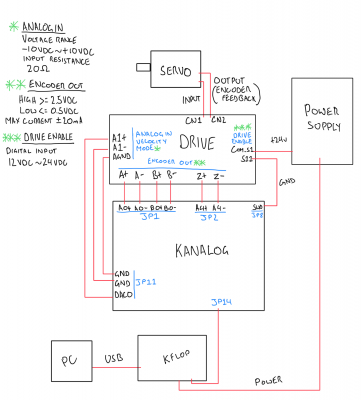

Thanks for the clarification, I managed to get an external power supply hooked up.

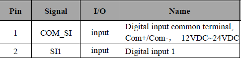

Below is the specification of the Drive Enable Input as well as a Diagram of how I have wired everything.
Drive Enable Pins.png (8.04 KiB) Viewed 34032 times
I managed to get the drive and motor communicating with Kmotion but am now stuck with the tuning.
I am also uncertain if the wiring needs any optimization given resistances or anything else.
A strange thing I noticed when I give DAC0=10 and DAC=-10, DAC=100 and DAV=-100 and so on, I notice that the positive and negative voltage supplied between JP11 pin0 and gnd are not identical, it seems the positive always tends to get more juice. Will the offset provision in the Configuration section in kmotion be able to fix this? Am I rushing things, is there any advice you can give me please?
Also if the encoder resolution of the drive helps in any advice it is 23bit(8388608 ppr).
Re: Deviation observed on 3+2 axis CNC milling setup.
Post by TomKerekes » Tue Jun 07, 2022 5:01 pm
Hi Wilson,
Resistances shouldn't matter. Wiring should be short to pick up less noise.
Offset should not be an issue the Servo will compensate for it. See here.
I don't think the drive outputs that.

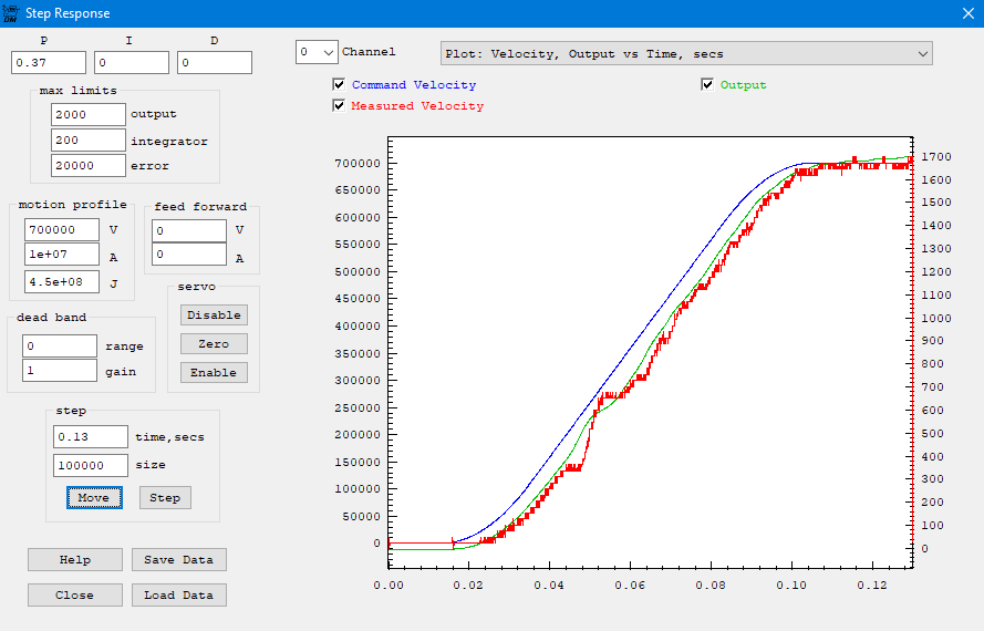

I managed to reach the motor tuning step, below are my results.
Configuration:
Running move the first time:
Running the move command subsequent times:
I tried fiddling with the settings but it only seems to make things worse. What do you think I could try optimizing?

Fiddled and fiddled. I think I made some progress...
What do you think?
Post by TomKerekes » Thu Jun 09, 2022 5:07 pm
Follow the steps here.
Describe what you see in the graphs. Can you see it is nearly unstable?
Describe what you did and what happened, not just the final plot.
Post the Step Response, Filters, and Config Screens so we know what all your parameters are.

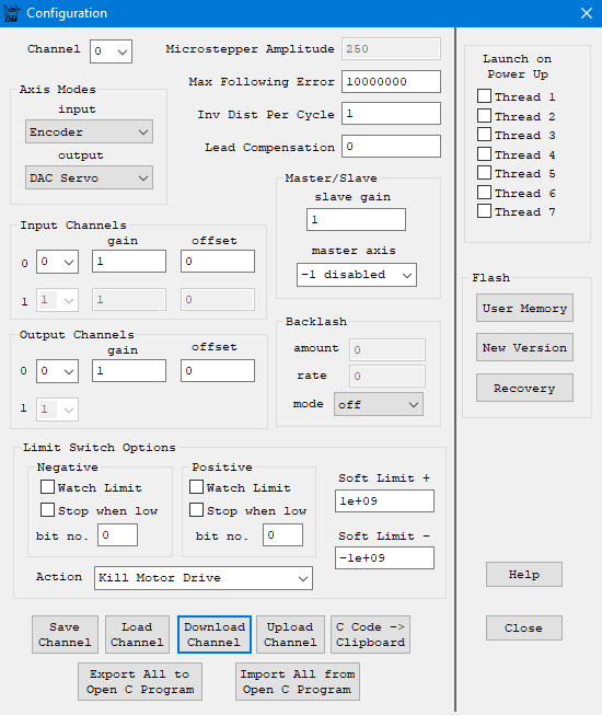

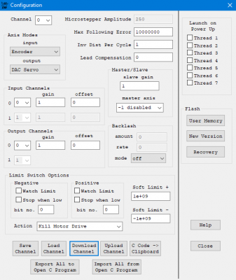

2. Opened the ‘Configuration’ Screen and loaded KanalogDAC.mot
3. Opened the ‘Step Response’ Screen, set max limits (output to 2000, integrator to 200, error to 20,000) enabled the servo and began tuning.
4. Found Max Velocity: Selected a Large step size (100000), Large Acceleration (10,000,000), Larger Jerk (100,000,000). Plotting and monitoring a ‘Velocity, Output vs Time, secs’ graph, I slowly Increased ’V’ (Velocity) and P (Gain) in small increments until the motor was maxed out, (this was the most frightening I’ve done in my life). Then I dialed back ‘V’ to about 50% of the maximum Velocity and gradually reduced the P Gain till it was just a little more than what was needed for the motor to achieve 50% of its maximum velocity. Ie. 460,000
5. Found Max Acceleration: Plotting and monitoring a ‘Command, Position, Output Command vs Time, Sec’ Graph, I dialed down the value till I noticed that the ‘Red’ (Position Line) Stated to get affected (acceleration slowing down) and from that limit I dialed it down 20%. Ie. 7,200,000
6. Found the Max Jerk: Used the suggestion on your wiki and set J at A/0.020. ie. 360,000,000

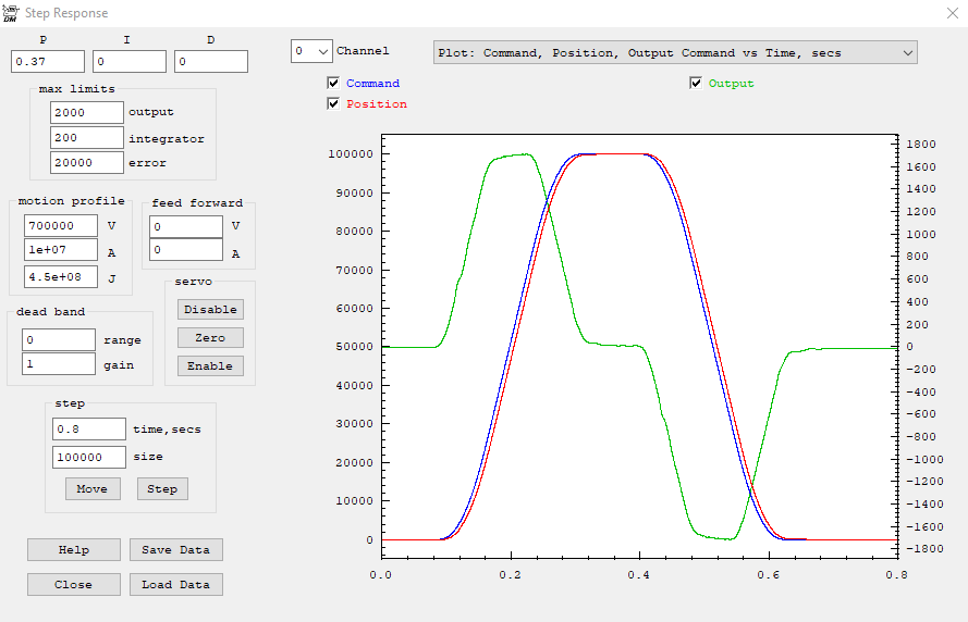

7. Increased the Test Move Step ‘time’ to 0.9 second and ‘size’ to 120,000 position units to see the graph more clearly. Tweaked PID and motion profile and finally got this as a result.
8. Using the ‘Position Error, Output vs Time, secs’ graph, I set the ‘Max Following Error’ to 20% more than what was recorded. Ie. 4,800

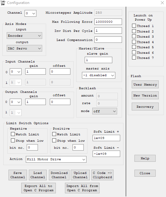

Here are the screenshots of the ‘Filters’ screen as well

1. Do you have any feedback on the graph shown in step seven?
Well you changed parameters laterso I'm not sure it is worth commenting. But mainly the max Accel was not being used. The acceleration is purely jerk limited. To ramp up to that acceleration would take 0.05 sec. And back down to zero another 0.05 sec total of 0.1 seconds. Getting up to max acceleration and back down would exceed your max velocity. Hence the move is Jerk limited. If you plot commanded Velocity and zoom in:
you should see that it is fully up to max velocity in ~ 0.05 sec not 0.1 seconds.
We have a 3rd order Trip Planning tool to help understand motion profiles which includes an acceleration plot. See Video. Here is a solution with your parameters:
Note the Acceleration peaks at 23e6 counts/sec no where near the 200e6 max setting.
Even 23e6 is very high. at 50800 counts/inch that is 453 in/sec2 or almost 1.2G
What are your velocity and acceleration requirements?

Sorry for the silence, it has been quite a hectic month. I hope all has been well with you.
I'm now back on task so without further ado, here is an update.
So what I had done in my previous post between point 6 and 7 was basically:
1. Pushed the velocity up to 550,000 from 460,000. - I assumed since the maximum velocity was 900,000, I thought I had a bit of wiggle room and pushed it up a bit more.
2. Plotting a ‘Velocity Output vs Time, secs’ I noticed that the operation was completing before the servo could reach the full speed so I increased the ‘step size’ to observe the results better.
3. Increased Acceleration till I noticed that the curve would not get any steeper.
4. Increased Jerk till I noticed the curves at the beginning and the end of the acceleration incline seemed to match between the ‘Command’ and ‘Position’.
5. Reduced the P gain till the servo would freeze and then bumped it back up a tiny bit.
Using your most recent advice regarding the max acceleration and using the TripWPF program:
1. Entered the current Max Jerk, Max Acceleration, Max Velocity and Distance and observed the graphs.
2. I noticed what you told me about the ‘Max Acceleration’ being capped by ‘Max Jerk’ and so reduced the ‘Max Jerk’ till the ‘Max Acceleration’ was not restricted and then reduced it a bit more to give a buffer
3. Reduced ‘Max Acceleration’ till the ‘Max Velocity’ curve looked more gradual
4. Reduced ‘Max Jerk’ again to further smoothen the curve and give a slight buffer to ‘Max Acceleration’ as well.
Then I did some calculation with what I would like to be the Max Velocity and the Max Acceleration.
Taking into consideration that
I aimed for a ‘Max Acceleration’ of 200 inches/s^2
200 (inches per second square) * 50800 (counts per inch) = 10,160,000
I rounded that down and set the ‘Max Acceleration’ to ’10,000,000’
Then drawing inspiration from
Then go back and push velocities and acceleration to see what you can achieve without causing excessive error if needed.
I aimed for 13 inches/s as ‘Max Velocity’
13 (inches per second) * 50800 (counts per inch) = 660,400
Ambitiously I bumped up the ‘Max Velocity’ to ‘700,000’ but the servo stalled so I increased the P gain in increments of 0.01 and then when it was stable I added an extra 20% to be sure. Ie. A value of 0.37 finally
Then I…
1. Fiddled ever so slightly with your wonderful TripWPF program updated the new ‘Max Velocity’, ‘Max Acceleration’ ‘Max Deceleration’ as well and experimented with ‘Max Jerk’ to smoothen the graph
2. Reduced the P gain till the servo stalled and bumped it back up a bit
3. Removed I and D for now since it didn’t seem to have much impact
And here are the final results.
Do you think I am moving in the right direction?
Did I make any mistakes?
Do you have any feedback?
