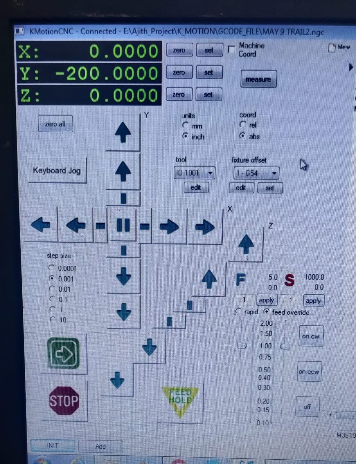

As you know, the above screen is the kmotion cnc screen and there is an option to jog the corresponding axis where ever i want. my question is that whether i can read or store the value displayed in the screen whenever i jog our axis, by pressing a customized button and use that value directly in my gcode variable. That is whenever i press that customized button my coordination value used in the gcode need to be replaced with that jog value.

See the SetFixtureZ.c example which reads the KMotionCNC DROs and uses it to adjust the GCode Fixture Offset by changing a GCode Variable.my question is that whether i can read or store the value displayed in the screen whenever i jog our axis, by pressing a customized button and use that value directly in my gcode variable. That is whenever i press that customized button my coordination value used in the gcode need to be replaced with that jog value.

When the SetFixtureZ.c program executes you should see the KMotionCNC Z DRO change to zero. You can see that a Fixture Offset changed by using the fixture offset edit screen. Fixture offsets for all the axes and all the fixtures are stored in GCode Parameter Variables starting at #5201. The Variable for G54 Z is #5223I had gone through the program but i have tested the program in kmotion but i don't know where the value is saved.
If you want the program to run when a User Button is pushed then yes.whether i need to assign the program in user button in toolsetup screen in kmotion cnc

Are you saying that if i jogged my motor to a certain position using the kmotion cnc screen and then execute SetFixtureZ.c program.the value in the dro will changed to 0 and the fixture offset value will be changed to the jog value. but when i execute SetFixtureZ.c program in kmotion ,i think there is a 'get' command used in the program to get value from the user but the program didnt wait to get value from the user.When the SetFixtureZ.c program executes you should see the KMotionCNC Z DRO change to zero. You can see that a Fixture Offset changed by using the fixture offset edit screen. Fixture offsets for all the axes and all the fixtures are stored in GCode Parameter Variables starting at #5201. The Variable for G54 Z is #5223

CorrectAre you saying that if i jogged my motor to a certain position using the kmotion cnc screen and then execute SetFixtureZ.c program.the value in the dro will changed to 0 and the fixture offset value will be changed to the jog value.
No it doesn't ask anything of the Operator.but when i execute SetFixtureZ.c program in kmotion ,i think there is a 'get' command used in the program to get value from the user but the program didnt wait to get value from the user.
See here.yes i want and is it possible to assign that c program to a button. and how can i do it.
