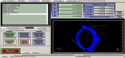

Good afternoon Tom. I have a problem with displaying a 4 axis toolpath. 5 axis is displayed correctly. how to solve this misunderstanding. I use KFLOP 4.35b Build 13:25:11 Jan 16 2019 . in match3 the trajectory is displayed correctly during the simulation. thank you hope you can help

Posts: 2916
Re: G Code Viewer Not Showing Toolpaths
Post by TomKerekes » Wed Apr 27, 2022 4:45 pm
Hi Igor,
What are you expecting?
What kind of machine is this?
Do you have kinematics?
How is KMotionCNC Configured?
How is the GCode Viewer Configured?

Post by Igor » Wed Apr 27, 2022 5:36 pm
1. correct display of the trajectory (mach 3)
2.Kinematics5AxisTableAGimbalB
PivotToChuckLength = 3.208661 //inches (81.5mm)
3.non-standard machine. turning and milling.
What else do you need to provide to help.

Hi Igor,
The GCode in the screen shot seems different than the file you sent me. When I view the file in Mach3 I get something different.
Please send the same file you used in Mach3 and post how you have Mach3 configured.

Post by Igor » Thu Apr 28, 2022 12:27 pm
good afternoon Tom. I did not set up anything in match3. as it is out of the box. trajectory is the same. i tried that maybe the problem is in the post processor... but i always get wrong processing in... that's the reason i bother you... i can't solve this problem myself)))
I also tried the "F" version. the result is the same, the trajectory is not displayed.. when changing to the inch scale. there is no trajectory at all ... very strange. I see that the trajectory was downloaded 3 times .. or is there no one on this forum who can answer questions except dear Tom?))
My system is windows 10 pro . Intel i7-4960X/ 16 g . graphics sapphire vega 64, driver version 20.4.2 .. any versions of the state are not shy)))

Post by TomKerekes » Fri Apr 29, 2022 11:01 pm
Hi Igor,
This is somewhat complicated to explain. But there are basically two GCode approaches: #1 with RTCP/kinematics and #2 without RTCP/kinematics.
Let's consider an example where we would like to engrave a groove around a cylinder's surface pointed in the X direction.
#1 To cut the Groove with RTCP we are controlling the Tool Tip so the Tool Tip should be commanded to move in a circle in the YZ plane to cut the groove. While moving the tool tip along the YZ circle path the tool angle might be also changed so that it is perpendicular to the cylinder surface. And so the A angle of the tool might be rotated 360 degrees while going around the circle.
RTCP is very powerful as the GCode can specify any arbitrary tool tip path with the tool at any angle along the path. The same GCode can be used regardless of the type of machine as exactly what is to be cut is specified by the GCode and the machine figures out how to do it.
The GViewer can just plot the tool tip path specified by the GCode to show what would be cut.
#2 To cut such a Groove without RTCP the tool is just moved to some point at a certain radius and then the A Axis is used to rotate the stock (cylinder) to cut the groove.
In this case the GViewer must create the path based on the radius and rotation.
Mach3 doesn't support RTCP/kinematics and must use this method.
I would recommend you change the CAD post processor to output RTCP GCode and use RTCP.
Otherwise KMotionCNC does support method #2 by specifying the A Axis to have a nonzero Radius in the Tool Setup. If you specify a small non-zero number such as:
A Radus TP.png (2.45 KiB) Viewed 6776 times
Also configure the GCode Viewer to display the A Angle based on radius with:
A GViewer.png (10.7 KiB) Viewed 6776 times
Then your GCode should then show a plot like this:

Post by Igor » Sat Apr 30, 2022 8:37 am
