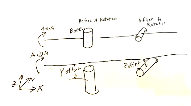

I would describe that as an offset not a pitch. The bore is offset from the faces. If you were to make the bore at X=0.1 and Y=0.1 instead of x=0 y=0 is the final result correct?
In that case I think that would indicate the X and Y Origin is not at the point of rotation for the A and C Axes. See here as I attempt to show how a bore Y offset becomes a Z offset after an A rotation. The top diagram attempts to show no Y offset that results in no Z offset for machining the face. The bottom diagram shows an exaggerated Y offset that results in a Z offset for machining the face.
