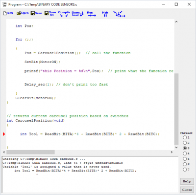

Ah. I see in CarouselPosition you aren't returning the result. If you would have followed my advice the Validator would have warned you of this:
btw 3 bit binary will be 0 to 7. To have 1 to 8 add 1.

Thanks Tom
the binary program is running now, it can read each tool using three sensors, one more thing regarding to ATC operation, why when i start cycle the spindle goes to the carousel to get the tool already in it, and also the pop up "set value tool in spindle" will always be there when power up the system? or is there some way to hide it and the software remember what tool was the the last one used?
