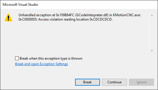

When I try to run/debug with the original fopen line in getParameter(), I get this error in the debug mode:
It also opens "strlen.asm" at line 69. Process is [6240] KMotionCNC.exe. Not sure exactly what to give you with this.
When I look in GetParameter and hover over MainPath, "MainPath = 0xcdcdcdcd <Error reading characters of string.>"

The 0xCDCDCDCD exception indicates the code is trying to use something that has never been set to anything. Naturally the strlen.asm code fails trying to work with invalid data.
MainPath is determined and set in the CCoordMotion class. Which the CKinematics class doesn't have access to. So after CCoordMotion creates the CKinematics object it sets a pointer to it in the CKinematics object it created with this statement in CoordMotion.cpp about line 162
Kinematics->MainPath = MainPath;
do you have this line? Set a breakpoint on it to see if it is executed. If the breakpoint is hit what is the value of MainPath then. MainPath by itself refers to the member variable in the CCoordMotion object as that code is in the CCoordMotion class. Kinematics->MainPath refers to the member variable in the CKinematics object.

It seems somehow GetParameter() is being somehow called before the MainPath is set in the CKinematics object.
Put a breakpoint in GetParameter and look at the call stack to see where it was called from.
The sequence should be:
#1 - create the Kinematics object
#2 - Set the MainPath in it
#3 - call Kinematics->Initialize(); is made which should make calls to GetParameter

Call stack at break in GetParameter before error...
> GCodeInterpreter.dll!CKinematics::GetParameter(const char * key, double * v) Line 784 C++
GCodeInterpreter.dll!CKinematicsBasicMapping::CKinematicsBasicMapping() Line 17 C++
GCodeInterpreter.dll!CCoordMotion::CCoordMotion(CKMotionDLL * KM) Line 152 C++
KMotionCNC.exe!CFrame::CFrame(CWnd * pParent) Line 34 C++
KMotionCNC.exe!CKMotionCNCApp::InitInstance() Line 85 C++
[External Code]
[Frames below may be incorrect and/or missing, no symbols loaded for mfc140d.dll]
KMotionCNC.exe!WinMain(HINSTANCE__ * hInstance, HINSTANCE__ * hPrevInstance, char * lpCmdLine, int nCmdShow) Line 26 C++
[External Code]
Posts: 2901
Re: Basic XY Screw Mapping - Geo Table
Post by TomKerekes » Mon Feb 28, 2022 11:46 pm
Looks like you are calling GetParameter from your Constructor rather than the Initialize function.
Note the Initialize function is virtual. If you don't have one the one in the CKinematics base class is called which does nothing. So if you don't have an Initialize function you will need to add one in your class to override the base class.

That did it! Thanks!!!
