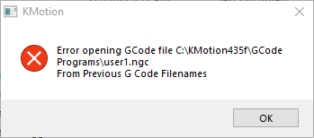

A thought back to my path issue in the GetParameter(). Maybe related, while running KmotionCNC, I sometimes get a notice something about not being able to find the gcode files (I think it has had trouble with the blank files more).
I figured I screwed up something with the default path from within the machine parameters, but have not yet been able to figure out where. Could this be related and the source of why GetParameter's mainpath does not properly find the data directory?

That message occurs when you press New File which defaults to userX.c but don't save it. If you then exit KMotion and re-launch KMotion it trys to re-load the non-existent file. I don't think that is related.
