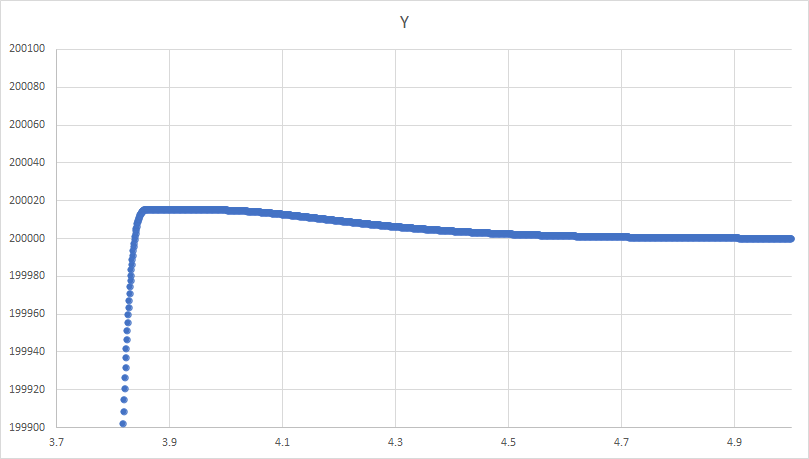

I'm having difficulty reproducing the problem. I only see about 20 counts of overshoot. I set the soft limit to 200000. But I had to comment out much of everything other than your MPG routine as I don't have your hardware. You might temporarily comment out everything other than the MPG call to see if the overshoot still occurs. I'm Jogging Axis 5 in quadrature mode 10000 counts/sec to simulate a fast spinning MPG. I've attached the modified files that can run without any hardware that I used and also the data capture program. Again strange it would only do it on one axis.
