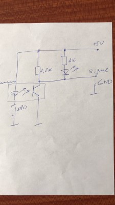

I installed 6 pcs of 1 nF filter capacitors right next to the KFLOP, replaced all the limit switches with ones from Omron- as per the attached datasheet, on which I connected a 2K resistor between Output and Vcc.
I don't see the data sheet.
