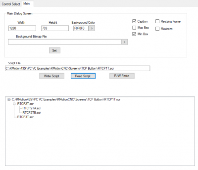

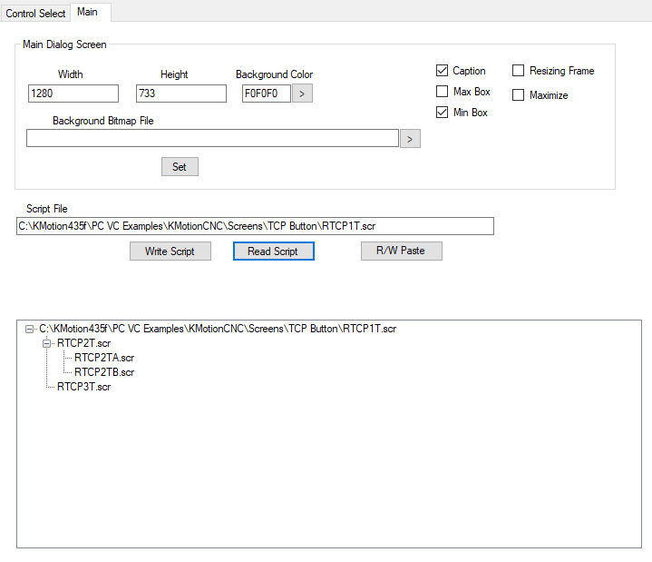

Attached is a Screen Editor that should read Screen Script files with nested SubScripts. It also shows the hierarchy. But can't write them. I've attached an example with a main RTCP1T and 4 subscripts.

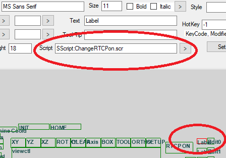

I was a bit confused by the RTCP2 file content. It included the base page content plus the additional content of the subscript. I've included modified files RTCP1_LJD.scr and RTCP2_LJD.scr that represent what more of what I'm trying to implement. Initially it didn't work. I think the problem I was having was caused by my trying to load the base page using the Screen Editor. Once I went into the GCodeConfigCNC.txt file and change the screen to load, it worked. I think the bottom line is that the base page can only be loaded directly by KnotionCNC (as you indicated). My files didn't use the include because I didn't realize it was available. So I still need to figure out why my button actions couldn't load subscripts with incompletely defined controls. But with the example you have given me (But30 & 31) and knowing to not try to load the base page with Screen Editor, I should be able to track it down. I'll confirm when I get my screens working or will be back with more questions
I do have one question now. Can a subscript include another subscript? The reason I ask is that I'll have button actions that load a subscript to update a screen area shared by other button actions. I'd like to have a common subscript that all of the button subscripts can include that will put that screen area into a known state (i.e. set all controls used in that screen area to Hidden and reset the color of all the buttons).

The new Screen Editor works great, thank you! I like that it keeps the content in the order read in when it does a write out.
Is it possible for the editor to put a marker comment in the output to indicate the file where each script segment came from? Alternately and maybe a better more general solution would be to allow comment lines in a screen script. The user could put a comment at the top and bottom of each subscript file that indicates which subscript it is. If these comment line were included in the write operation, that would be all that is needed.
Supporting comment lines would also be helpful in organizing screen script content. Comments could be added with a text editor so Screen Editor wouldn't need to implement a means for entering comment lines. Maintaining blank lines would be nice too.
