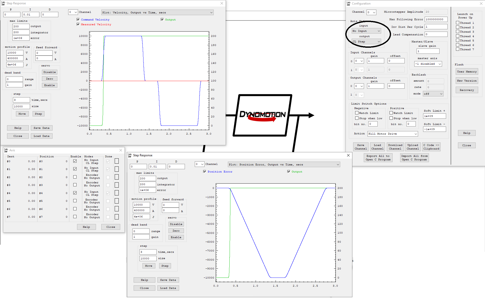

Do I have to adjust encoder into kflop or does the wiring look right
Re: Stepper Hybrid - JP7 vs JP5
Post by TomKerekes » Thu Sep 09, 2021 12:54 am
You don’t have any encoder signals going to KFLOP. No encoder data is going to KFLOP. How do you expect KFLOP to know the encoder position? Magic? 😃
Set the input modes of your axes to “No Input”

:lol: Now that input is set to no input and output is set to CL. Does that mean the encoder is taken into account from the driver and actually being used or no use?
Post by TomKerekes » Thu Sep 09, 2021 5:05 pm
You can not set KFLOP to Closed Loop as there is no position feedback going to KFLOP. KFLOP is blind to any errors and must operate in an open loop manner. How could it correct errors if it doesn't know what the error is?
The drive is supposedly closed loop. I couldn't find any manual for it. But it appears to have an Alarm Output. You might interface that to KFLOP so that if there is an alarm KFLOP will be aware and be able to do something such as stop.
