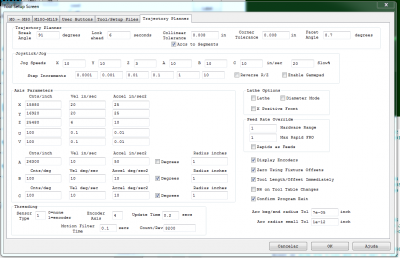

Lastest version with this dll: viewtopic.php?f=11&t=1359
TP settings attached.
Max following error is set to 100. |In the step response I get a max error of ~40 steps. At about 5x times the feed of the cutting program.

Attached my init program. (TP config already sent.)

Using the g-code attached and the TP configs attached it runs perfect.
Reduce FACET ANGLE to 0.5 degrees and it triggers a following error. ( even if i use feed reduced by 50%)
