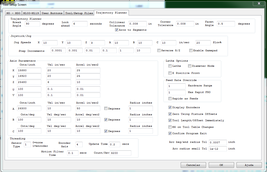

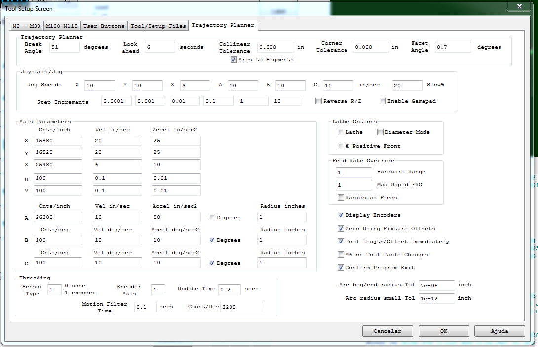

Lastest version with this dll: viewtopic.php?f=11&t=1359
TP settings attached.
Max following error is set to 100. |In the step response I get a max error of ~40 steps. At about 5x times the feed of the cutting program.

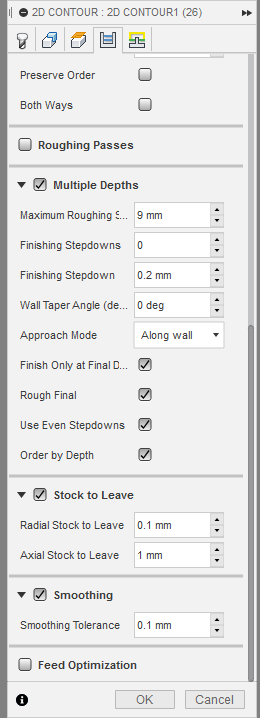

So I went to Autodesk Fusion 360 and added 0.1mm radial stock. (photo attached) The program runned fine without cutting any stock.
I placed the stock at the machine, and the machine cut all part fine.

Radial stock adds material between your tool and your material.
e.g. you are doing a roughing operation, you give a 0.5 radial stock and then you come and finish that 0.5mm of material.
I just used it to change the way g-code was post processed, so would not bet the same lines and g-code.
A easier way to reproduce the error:
Using the g-code attached and the TP configs attached it runs perfect.
Reduce FACET ANGLE to 0.5 degrees and it triggers a following error. ( even if i use feed reduced by 50%)
Hope this way is easier to reproduce.
