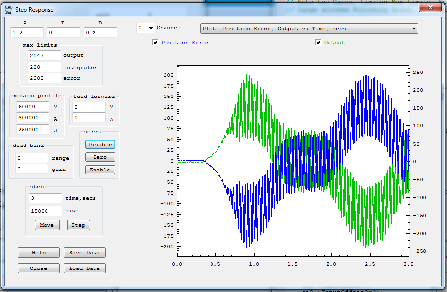

Tom, here goes both of the plots. with P1.2 (strange) and with P1( ok )
Changed some settings also.
I can't save data and upload as it is 1.4mb and the forum only accepts 1mb.
SETTINGS:
That is classically unstable.
The next step would be to find max D gain and to see if it then allows higher P gain.
