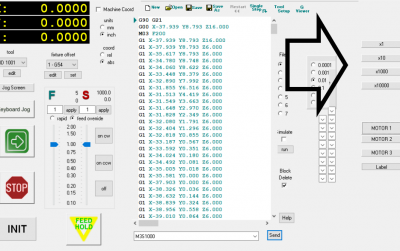

HELLO, TOM, GREETINGS. I'm trying to put buttons on the KMOTIONCNC screen, I just need them to send me a value that I can use in a C program. Is there a way to do this? I am only using KFLOP.
For example, I have 4 buttons with 1, 10, 100 and 1000, suppose I select the one with a value of 1000 (in my case they would be pulses that I will send to a motor) then when I press the motor button 1 a C program is executed where it reads the value of the selected button 1000,and 1000 pulses are sent to the motor, is it possible to do that?

Re: Feedhold Backwards/Forwards speed
Post by TomKerekes » Sun Feb 11, 2024 6:31 pm
Hi Ibzan,
There isn't currently a way to read the text of a pushbutton. But if the text doesn't change then you might just code the value into the C Program for the button. Or you might pass the value to the C Program as the Actions Param.
Another option might be to use Edit Controls with buttons right next to them. In this case the C Program activated by the button could read the edit associated control. This would also allow the Operator to easily change the values.
