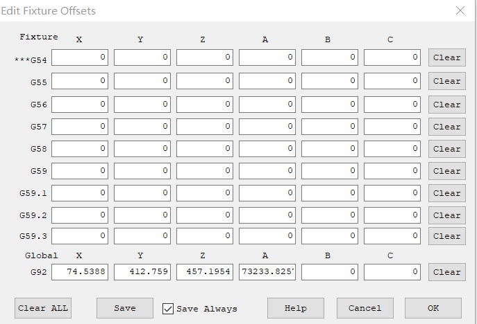

4) At the end of this test, I click the "edit" button of CNC window to see what is the value of fixture offset for 1-G54. The capture screen is:

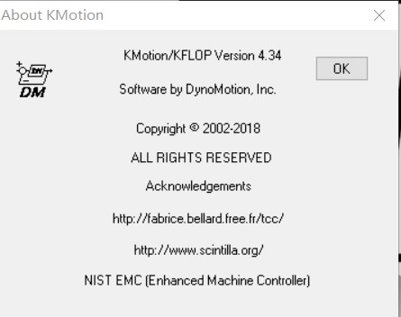

6) And the kmotion version is:

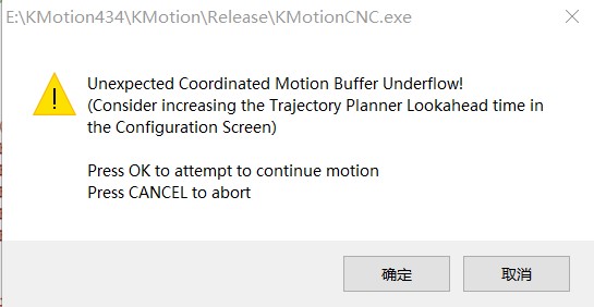

I have run 3 time. Every time the second line of gcode can work. But there are two times the system report buffer underflow error after I click the red stop button of Kmotion or Kmotion CNC (I did this because the system has stopped and in "Feed Hold" status after the z-axis hareware limation was touched). It is:

Posts: 2916
Re: The problem with limitation swich configuration-II
Post by TomKerekes » Sun Aug 02, 2020 5:28 pm
Hi Huang,
The problem is you have huge G92 Offsets:
So when the GCode commands X8.793 the machine will move to 8.793 + 412.759 = 421.552 mm !!
Clear these to zero or set them to reasonable values.
You probably created these huge offsets by "zeroing" the DRO when the machine commanded to some large value.

Yes, you are right! The problem is solved after I set all of them as zero. The gcode can run and the motor will go to the destination. Yes I has ever clicked the zero button of the kmotion cnc to study what is the meaning of coordinate. I will study the datasheet carefully.
