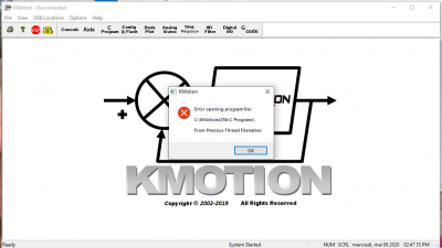

Hi, I open kMotion on my desktop. I push the "C Program" tab and I have an error: Error opening program file: C:\KMotion435b\C Programs\ From previous thread filenames. What can I do? I don't remember the last filename.

i just want to view a c program and probably modify them.
1) I open kmotion
2) I push on the tab "C Program"
3) If it's the first time, an error appair: Error opening program file: C:\KMotion435b\C Programs\ From previous thread filenames
4) Nothing open and I can't view any c program.
5) if I retry to push the tab "C Program", nothing append

Hi, I try to make what you said, but I don't understand very well.
I open kmotionCnc and open tool setup, but I don't know where to search.
I try also to change the opening page in screen editor to custom and retry, same error.

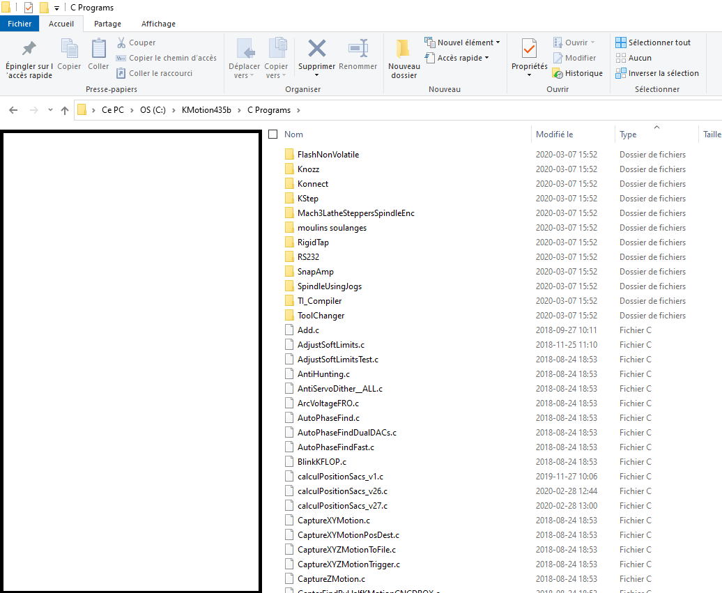

The error is because the last filename is blank. You can ignore that error. Does the C Programs Screen open after clicking ok to the error? Its up to you to know what C Programs were created for your system. You might search by date to see which .c files were modified most recently.

this is the problem, the c program tab with the seven thread didn't open after ok in the error.

The positions of the Screens are stored in a file C:\KMotion435b\KMotion\Data\persist.txt. You might check that and compare to one of a fresh installation.

I will try what your said, but first I don't find your file C:\KMotion435b\KMotion\Data\persist.txt.

I renamed my existing kmotion435b folder and I reinstall. It works now. However, I still can't find your persistent.txt file.
