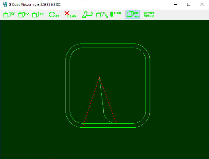

Hi Scott,
Looks like you forgot to turn off Radius Compensation with G40.
See the example: ToolRadiusInternalContour.ngc
It demos a path with and without compensation turned on.
Note you might want to select the Fanuc mode of compensation entry mode. See the
wiki.
- RComp.png (9.04 KiB) Viewed 5616 times
