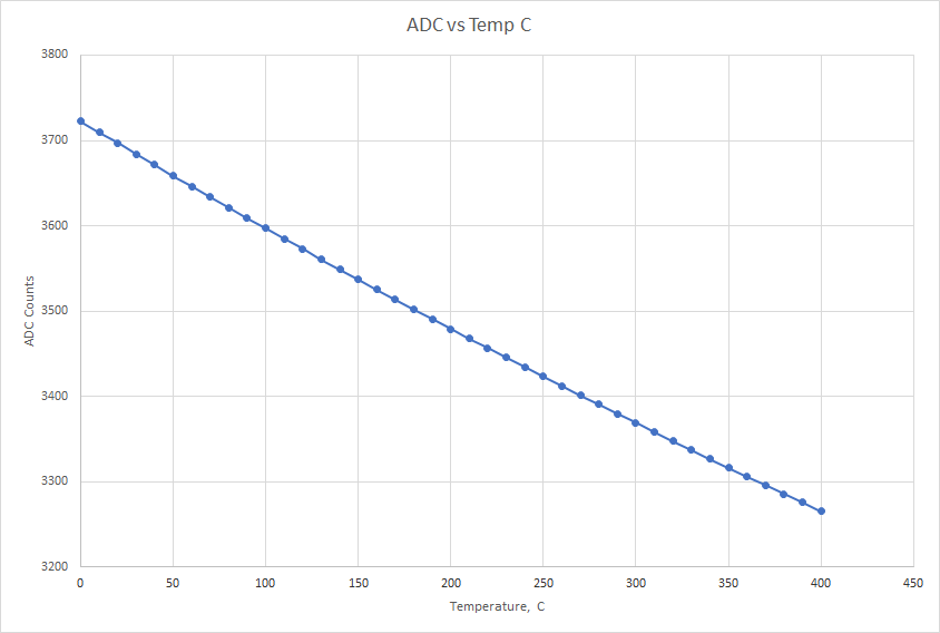

Hi Scott,
The 1000 ohm Version might work reasonably well.
32208571
Connected directly to KNozz the resolution would be 1.1 ADC Counts/Degree
Device current would be maxed out at 0.3ma
See Plot below:
