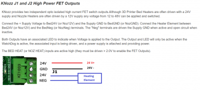

Just plugged in my KNozzle to test it out. As soon as I run "KNozzControlTemptsMCode.c" the watchdog signal kicks on, and the heater turns on. Checking the console, it says the nozzle and bed setpoints are 0C, and I dont have any thermistor hooked up. Does this seem right? The documentation is slightly confusing about where the power goes. Is my image here correct?

I tried to add a picture a number of times last week, but it wouldnt attach. It shows in the bottom, but when I click the "preview" button the attachment is removed. I tried a JPG, TIF, and PNG file format.
No I didnt use an M-Code, the P and Q parameters are both Zero. That was why I was surprised that the coil started to heat.
