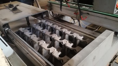

Hi, I have Kflop + KAnalog with mach3, in a Router Biesse Rover 346, servos and drives Yaskawa analogs +- 10V, they has been configured and work well but when I try to configure an OUTPUT in Mach3 they not work and in some times an axis begins to move, my first intention is control the outputs to config the tool changer

if you can provide some details about the tool changer (photos would be good), what outputs/inputs it needs, and the required sequence, we'll be able to help you far better.
Having just had a quick google, it looks like it uses a variation on a wine rack changer with pneumatically lifted tool holders - https://www.dailymotion.com/video/x2j9fqd
But I did see some photos of what looked a more standard wine rack...

I have a macro that use in Mach3, I need outputs to activate solenids to down bit drills and up tool holders, to libery tool from spindle motor, etc.

This Rover have 36 bit drill positions, 15 cone holders (ISO30), 3 spindle, 1 spindle 90° that can rotate 360°, 1 spindle circular saw can rotate 90°. Well I use a PLC to Multiply outputs using binary configuration, My principal Spindle Is only One, I would like to use the circular saw, all tools positions (15 + 36), and air blow.
This router move to tool position to change every tool, in a few minutes I send the process to change tool
