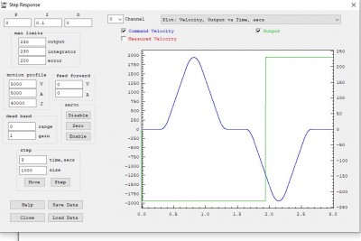

can you show me an example of the right (standard) work of the encoder?
The red line should be smooth and follow the motion of the axis. Such as:
