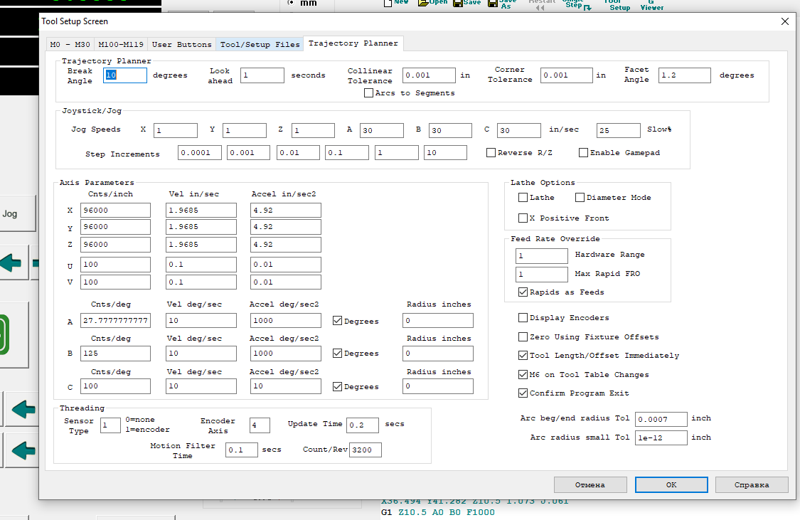

2 - not true - + . has 5mm/turn. TBI C3 2005
3 - is not true. At 96000 - making a test run at a distance of 240 mm. I have actual mixing only 237.45 mm. swarms of 97500 - 240 mm

Hi Igor,
step resolution is 19200steps/rev / (5mm/rev / 25.4mm/inch) = 97536 steps per inch.
Input gain = Steps/Count = 97536/25400 = 3.84

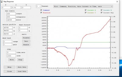

Change Input Mode to Encoder to make Encoder work:
Set P Gain to Zero. Set V to Velocity to Move in Steps/Sec. For example to move 0.5 inches/sec put 97536 * 0.5 = 48768

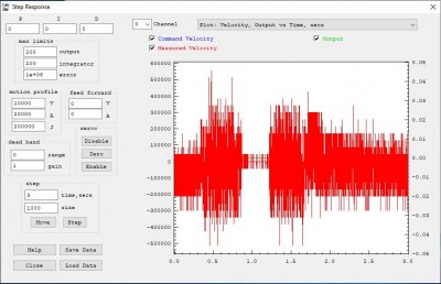

Only Plot: Command, Position, Output Command vs Time (Your drives don't have current or voltage measurements)
Encoder seems bad or picking up noise.
#1 - Set P I D to zero (no feedback)
#2 - Move slowly with low acceleration. V=10000 A=20000 J=200000
#3 - Post a Plot
#4 - describe what the motor does
#3 - Post a Plot

Good afternoon Tom. During these settings, there are no anomalies in the motor driver operation. Motor shuts in normal mode. Axle is mixed without breaks and any postage noises

Re: KFLOP with linear encoder
Hi Igor,
The Encoder Position looks like garbage. Probably picking up noise from the Stepper Motor wiring. Are you using shielded cables? Test the encoder by moving the axis by hand.
