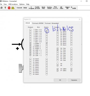

Step 1 - I have a servo stepper motor leadshaine HBC 2206/the driver has a microstep 19200 (64). In the program kflop 97500 pulses... The 290 mm test is good. Has a ruler accuracy of 0.001mm. Motor is connected to 15-16 pin. Digital line is connected to 7-8 pin.
Step 2 - I start Kmotion, I see the state of AB pins flash alternately. this correct state?
Opening the tab (AXIS), seeing the state -50944.50/-50945 is the correct state?
Yes if the Encoder is moving any amount.

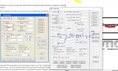

You have not configured anything yet.

Regarding "No active" - that is correct. The mode only has one Input and one Output
Regarding "blinks" - correct whenever the encoder moves
Regarding "Enable off" - Your Input and Output channels are wrong. So you get a following error.
Change Input Channel to 0
Change Output Channel to 0
Change Max Following Error to 1000000000
Push "Zero" on the Step Response Screen
Push "Move" on the Step Response Screen
Post the Plot
Post all your Screens.

We also need the specifications on the encoder resolution and your mechanics (Step resolution) to set the InputGain to match the encoder counts to the motor steps. Then verify it is correct with KMotionCNC Step Response Screen.
