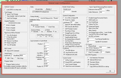

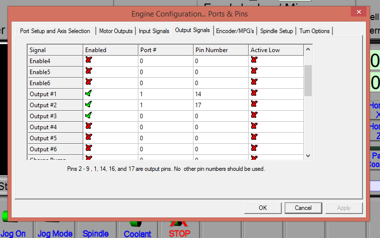

I have gone as far as I know to do with Mach Turn. I have something set wrong for the spindle. I can home to the limit switches as per your settings. The X and Z axis seem to work properly for travel. They are tuned to give exact movement per the KMotion encoder readings for travel commanded. The spindle starts when commanded somtimes, but not always. The spindle speed is never at the command called, but I can get close by adjusting the percentage adjustment. Threading looks like it is working, but when actually tested it is not starting the thread at the same rotation each time. I did install the license file hoping that was the problem, but no change. Can you see a wrong setting?
Scott

I think your Spindle Encoder is 2000 counts/rev not 1024 counts/rev as you have in the Mach3 Plugin Config. That would explain Threading not working.
Also Mach3 has this concept of "pulleys". So you would need to set which pulley is in use and set the max RPM for that pulley appropriately. Then make sure the Spindle C Program commands that speed when told to go 100% full speed by Mach3.

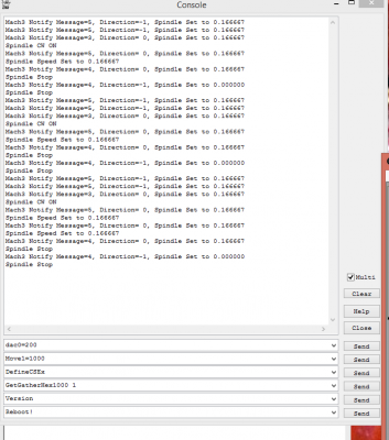

Thanks again Tom for your help. I missed seeing the incorrect count entry. I think the threading is now working correctly. In regard to the spindle not turning on all the time in Mach turn, I tried to get a better observation of the way it is acting. Once the spindle is on, changing the speed seems to always work. M05 always works. When M03 or M04 work, the console shows the actual running condition. When the command does not work, the console just shows M03 or M04. Observing the DAC output, when the spindle fails to start there is no indication of a change in output for the spindle. I know Mach is not your thing but thought this might mean somthing to you. I included a shot of the console readings.
I think the issue is that the way the C Program SpindleMach3Jog.c is written the S command is ignored when issued with the Spindle Off which is good and correct. But then if an M3/M4 (by itself) is issued to turn the Spindle On, the Spindle speed is not being set and remains zero.
The attached program should command the Speed properly for a M3/M4 issued by itself.
