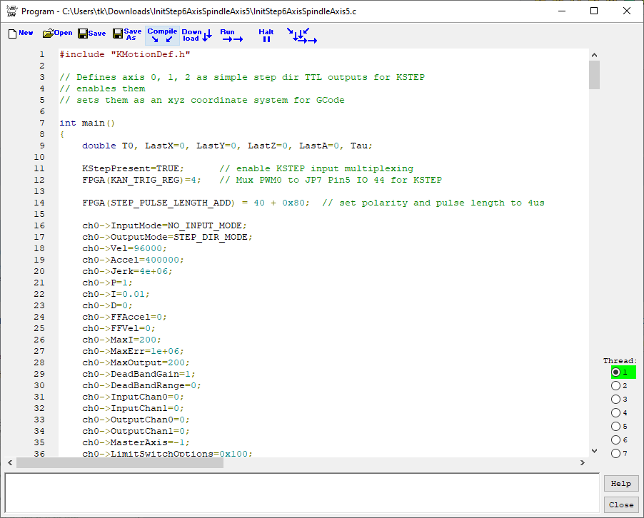

Hi Igor,
Here is the file you attached. It is different. Which one are you using?
Re: RTCP 5 axis machine
The last correct, if you select any configuration file, the blinking does not disappear
- Posts: 2677
Hi Igor,
I don't understand. Why did you send the file with the line still in?
You must re-boot KFLOP after removing the line.
The last, with the line removed! And the blinking problem persists on any other configuration files! Error should be ignored
- Posts: 2677
Hi Igor,
Please put more effort into your responses. Respond completely to everything, not just one thing. otherwise things take much longer to solve.
Did you re-boot KFLOP after removing the line?
yes. What exactly do you mean by "download"?
- Posts: 2677
Hi Igor,
I don't recall saying "download". Did you mean "re-boot"?
You might Flash "New Version" if you Flashed anything such as KStepPresent=TRUE to remove it. Did you ever Flash anything into KFLOP? We don't recommend ever doing this. To be absolutely sure Flash "New Version" to be sure KFLOP is in a default state.
Hi Tom thank you the blinking problem is gone. Did I understand correctly that every time you change your programs, you need to update Flash? I have very convenient scripts for mach 3. How do I implement this functionality in Kflop? Search for the center of the procurement, search for the angle, with output for each operator on a separate button. There are ready-made templates? And how to engage them. I worked for many years with mach 3, here decided to try your program, people say that one of the best available solutions.
