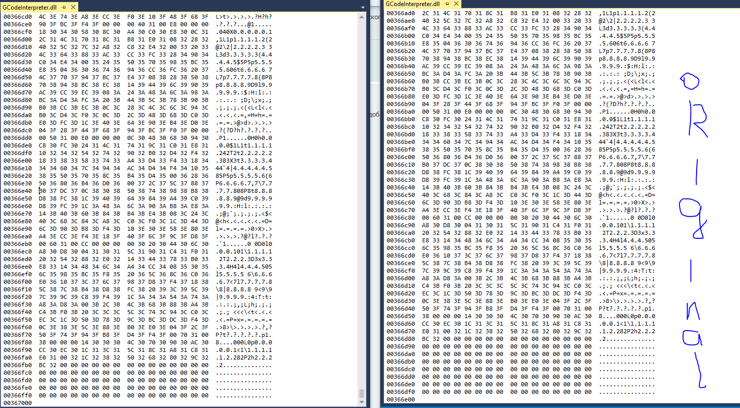

Thanks for not sleeping at this late hour. But the problem persists with the original file the program works. With a new net.on the screen on the right original file. I don 't have something in my compieter? you need more information and help me?

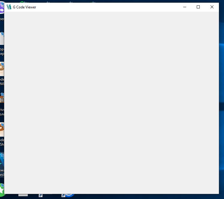

1 step - I install KMotion CNC 435b. After running the program I receive such notification ..
Step 2 - I copy the replacement file- "DSPKFLOP.out - 14.08.2018"
3 step - added "kinematics" file. At simulation and 5 axial trajectory. there is such picture 4 steps - When you add a GCodeInterpreter replacement file, the program does not work. do you understand me?

Re: RTCP 5 axis machine
Step 2 - new version, reloaded board, added file (replacement) GCodeInterpreter. the program is not started.In 3 seconds the program closes
The program works, but when you press G Viever, it collapses (closes) where you take the correct DSPKFLOP file. Out ?
Hi Igor,
The file is "GCodeInterpreter.dll" not "GCodeInterpreter."
Please try the following:
- Disconnect KFLOP USB
- Rename C:\KMotion435b -> C:\KMotion435bxxx
- Install KMotion435b
- Delete C:\KMotion435b\KMotion\Release\GCodeInterpreter.dll
- Copy new GCodeInterpreter.dll to C:\KMotion435b\KMotion\Release folder
- Right click C:\KMotion435b\KMotion\Release\GCodeInterpreter.dll | Properties | Unblock
- Windows Security | Virus & threat protection settings | Real-time protection | Off
- Double click C:\KMotion435b\KMotion\Release\KMotionCNC.exe
- report what happens
