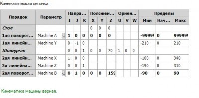

Implemented the RTCP function on a 5 axial machine.
It was not the first time.
I had to contact the developer for help.
Thanks to Tom for his help.
The configuration of the machine, as in the picture.
The configuration files Tom sent me.
Result on video.

Good afternoon. I need help in machine configuration. I have such kinematics that it is necessary to make changes in the Kinematics5AxisTableAGimbalB .cpp. according to my configuration. I am not strong in programming, I would like to see a guide to application. thanks

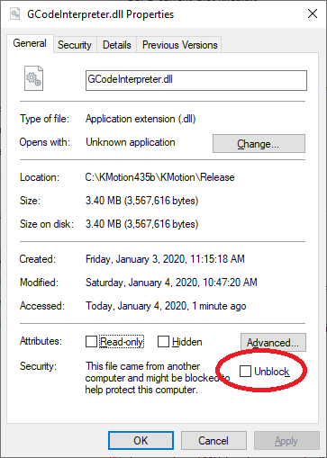

To apply the patch, copy this GCodeInterpreter.dll to the C:\KMotion435b\KMotion\Release folder.

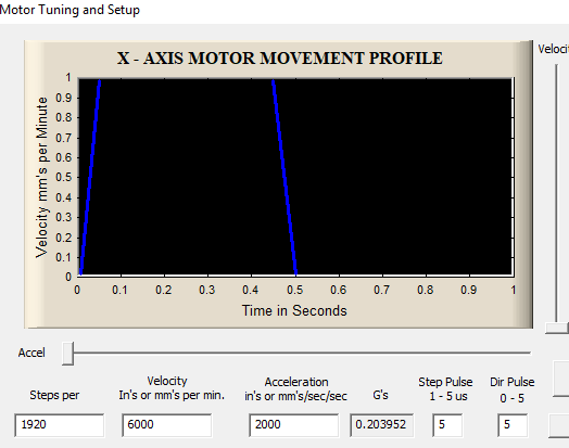

Post by Igor » Sat Jan 04, 2020 3:30 pm
good afternoon. Problem copying (copy this GCodeInterpreter.dll to the C:\KMotion435b\KMotion\Release folder) with replacing program file "closes." it is possible to hear your recommendations on settings of Leadshine NEMA34 motors of 1143 ounces 8Nm the closed contour the step engine a set 863HSM100H-E1 H2-2206S 3 phase - these motors operate axes of X,Y, Z/axis A - the step motor, through a reducer 1/50. Axis B stepper motor, via 1/100 reducer. Settings are taken from mach3. Also do not understand where it is necessary to add GCode G43.4H1, make changes to the postprocesor. A managed program is created in Delcam PowerMill 2016. Thank you for answering so quickly
I don't understand what you mean by this. Sometimes when downloading executables from the Internet Windows blocks them from executing unless you "unblock" them. Try right clicking the file, then select properties, then check unblock to see if it helps.
I couldn't find a proper manual/specification for those drives.

yes I know mach3 does not support rtsp. settings cited as an example. here is the official site please see there. http://leadshine.com/productdetail.aspx ... =ES-DH2306. Unblocking doesn 't work, KMotion doesn 't work.
