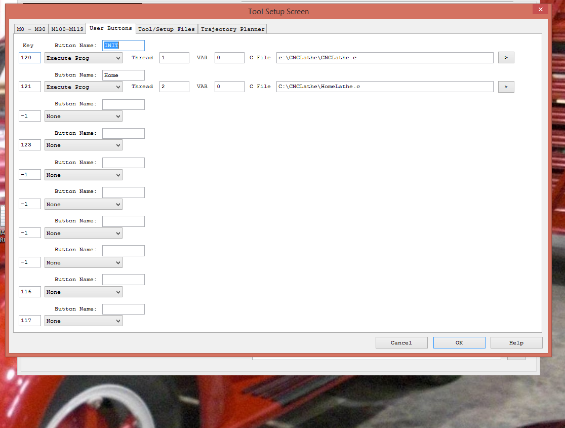

Try setting the Actions for M3, M4, M5, S to "Exec/Wait" instead of "Execute Prog"
Otherwise it might be some mixup in which Variable the speed is being sent and what the Programs are expecting. Please post (attach) all .c and .h files from your CNCLathe folder. Also screens shots of how all the Actions are configured (KMotionCNC Tool Setup Screens).

I tried changing the actions to the "Exec/Wait" settings and KMotionCNC did not seem to like that so I changed it back. What I learned after running the lathe with G code programs is that it seems to run as it should dependably until I add the G96 to the program. I think that is introducing some kind of error into KFlop. Even if I take it back out of the code the spindle will not work correctly until I close out and reopen KMotion. Then as long as I do not try using CSS all seems to be good. I have included the shots of tool settings and I think, the requested files. I included 10 attachments with this and will post again with another 5.

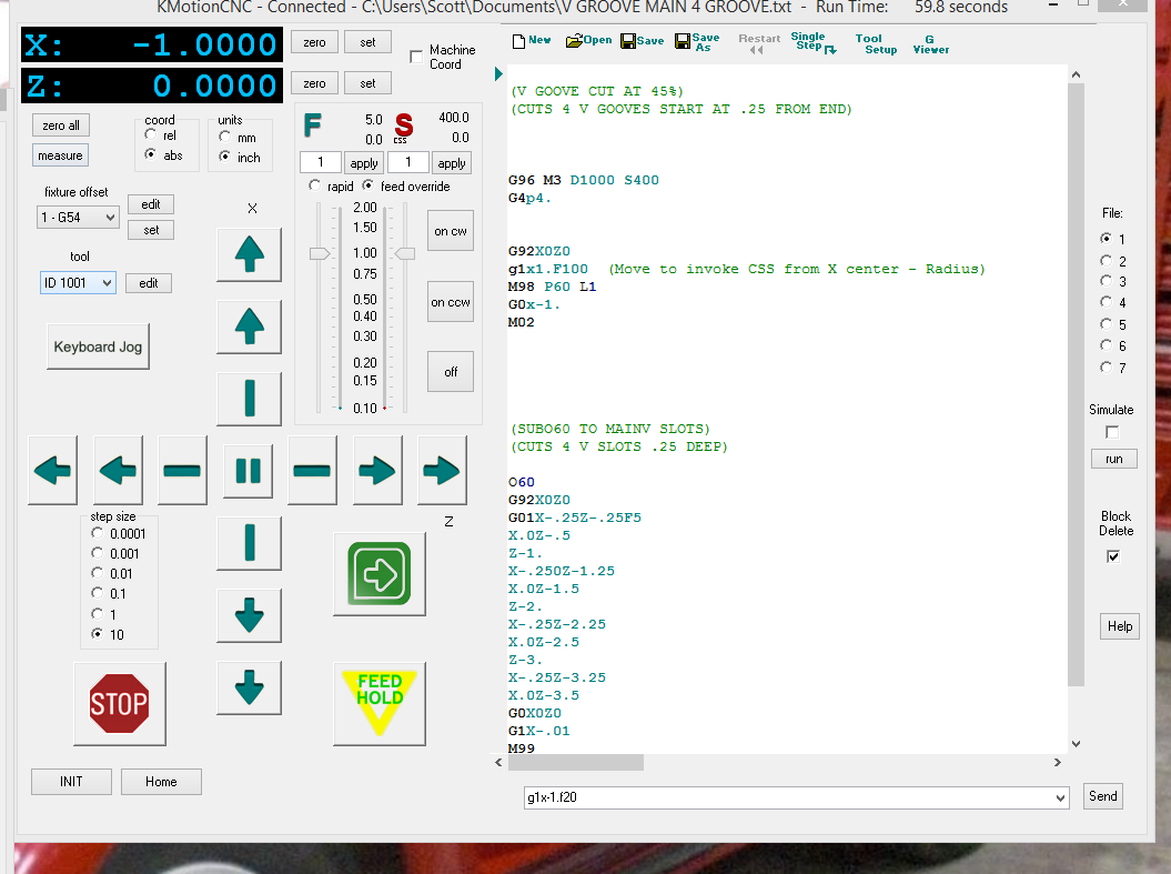

Hi Tom,Here is my attempt to provide what you need to see. This G code just sets zero and then advances in X from the start point. If you need me to run a different sort of program I can. Thanks for clarifying the threads question. I was not able to catch the KMotion screen before spindle faulted out, so that is a still shot of the program ran.

Ok it is now clear what is going on. Because the test starts out with a radius of zero the RPM should be infinity. Since infinity is not possible the maximum RPM should be used. But there isn't any max RPM specified in the GCode. In this case the default maximum of 1 billion RPM is used. Obviously the system can't do 1 billion RPM and soon faults.
Specify the max RPM with a D word like in the example here.
G96 M3 D2500 S159.6 (CSS should be 1000RPM at R=25.4mm)

Thank you for your wisdom again. I changed the C program as per your instructions and that fixed the spindle faulting problem. I feel like it is really close to 100% again now. I changed the G code program to move to start at X 0 and then move to a 1" radius. If I understand correctly that should invoke the CSS. I have included a shot of the G code and the console print. Once in a while the CSS is applied correctly and the spindle speed changes as it should. The red speed change indicator acts correctly all the time. When the X axis is moving in toward center it shows the speed increasing and visa versa. Most of the time the speed never actually changes and the analog screen shows the DAC output for the spindle as a steady voltage. There seems to be an arbitrary disconnect between the command and the function at KFLOP. Does this bring anything to mind that I should check?
