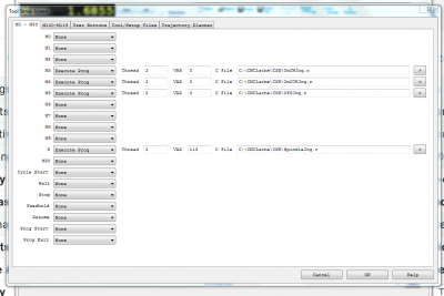

Thank you Moray and Tom for your help. I think I made some progress, but still not quite there. I did not find the correct file. I went to operating system and opened a new file. I named the file CNCLathe and moved the programs into it from the backup file. Went to KMotion CNC and changed the user button for init to the C:\CNCLathe\CNCLathe.C Went to config screen and opened the C program window. Opened the C:\ CNCLathe\CNCLathe.C and it does now compile. Now have a new error on KMotion CNC intit. button. I have attached the shot of this.

The "unknown extension type" error is because the Compiler expects a .c extension (lower case) rather than a .C (upper case). Change:
c:\CNCLathe\CNCLathe.C
to
C:\CNCLathe\CNCLathe.c
Also be careful with regard to spaces, they often matter.
