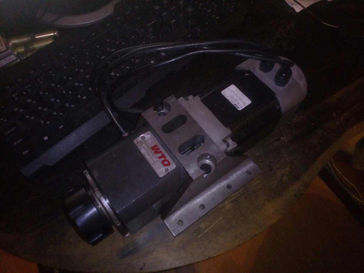

Hello! I'm collecting the machine. I will connect the encoders, so I decided to buy KFLOP. The axles are controlled by step/dir. Spindle with analog control. I bought a PWM conversion board in 0-10V. (a photo). If I still understand in the electrician and can disconnect the wiring, then in programming, a full zero. I ask for help on correct adjustment of spindle control!
The maximum spindle speed is 5647 rpm.
P.S. Sorry for my English.

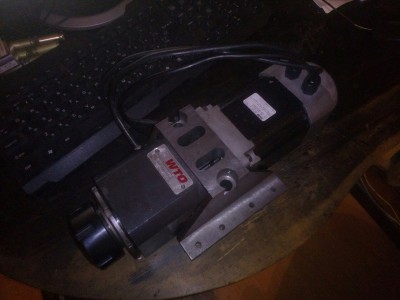

Post by Lafayette » Fri Feb 09, 2018 7:56 am

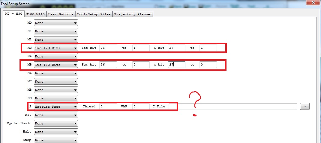

I want to use to adjust the spindle speed
JP6 IO26 Gen Purpose PWM0 out
I want to use to turn the spindle on and off.
JP6 IO27 Gen Purpose LVTTL I/O 3.3V

The first Step would be to wire up the KFLOP PWM signal to the DIN+ and a KFLOP GND to DIN-
Then you might use the PWM1KHz.c Example to output a 50% PWM signal which should create a 5V analog signal as a test.
	SetBitDirection(26,1);  // define bit as an output
	FPGA(IO_PWMS_PRESCALE) = 65;  	// divide clock by 65 (1 KHz)
	FPGA(IO_PWMS) = 128;  			// square wave
	FPGA(IO_PWMS+1) = 1;  			// Enable
You haven't described any way to turn off your Spindle. So I don't see how you could expect IO27 to turn the Spindle on and off.

I will turn on and off through the standard M code.
IO27 will be connected to the optocoupler, and it will command the servo amplifier S-ON/S-OFF
I do not understand why I need an analog output 5V. when it needs 0-10V.
And how you can change the spindle speed.
I don't think you told us about any optocoupler or what interface the amplifier has. Assuming IO27 can be interfaced somehow to turn the Spindle on and off then you probably don't need a C Program for M3 and M5. Just configure those to operate IO27.
That was intended to only be a simple test to output 50% to see if the hardware is connected properly and is working. You can change the value of 128 to other values to test other voltages.
Later you can use a C Program similar to the the one used for KStep's on board PWM to analog converter for the S Action. See the example Spindle_S_Kstep.c. Note the CorrectAnalog() function will probably need to be modified for the nonlinearities of your converter which is likely different than KStep's. If low speed control is not critical no changes may be needed. See:the Analog Output Section Here.
