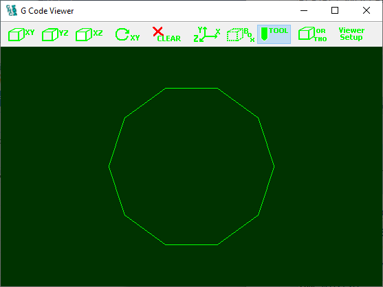

also i would like to learn if there is a repeating macro or command i can get to run the same cutting path then stop and index to a new position. then repeat this 32 times.
See the Polygon.ngc example that creates an N sided polynomial using a subroutine (O100) called N times:
(simple polygon)
#1=0 (start angle)
#2=10 (number of sides)
#3=1 (radius)
G20 G90
G0 X#3 Y0
F40
m100
M98 P100 L[#2+1]
M2
O100
G1 X[cos[#1] * #3] Y[sin[#1] * #3]
#1 = [#1 + 360.0 / #2]
M99

the Polygon.ngc example is absolutely over my head. i understand about 10% of it
It is very simple. If you told us what parts you understand and what parts you don't we could help. Its hard to help without feedback. Imagine someone telling you they only know 10% of how to drive a car. How would you help them?
Do you understand GCode Variables - #nnn ??
Do you understand formula of a circle - X = Radius * sin(theta), Y = Radius * cos(theta) ??
Do you understand the concept of subroutines - Beginning label (O100), Return from subroutine (M99), Subroutine Calls (M98) ? ??
