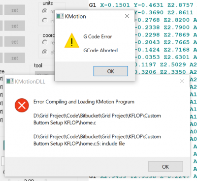

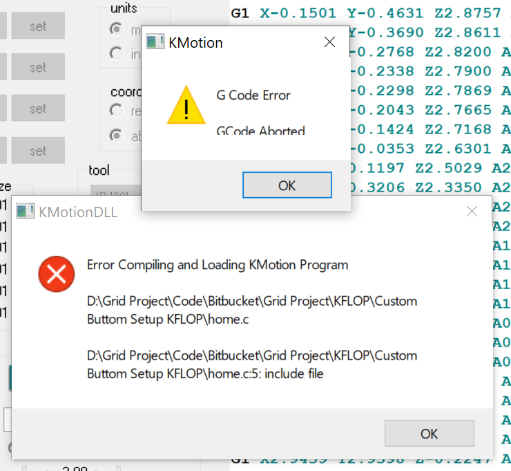

So not sure what I am forgetting maybe I need to include some paths or something but I get this error when I hit the home button while the gcode is running and if I first hit the pause button then the home it gives only the error compiling message. I set the feed rate at the beginning of every gcode I run with say "F60" and I change this from time to time. I do not use any offsets that I am aware of. I only have a "home.c" file but do not have a "home.c:5" that it seems it is looking for but not sure. It seems to not like the line: #include "KflopToKMotionCNCFunctions.c". It may only like .h files but no idea. I am stuck again. Thanks for any help.
Re: Add Home button in KMotionCNC
Ok I got it work it was a simple fix just made an absolute path for that one line:
#include "D:\Programs\KMotion434\C Programs\KflopToKMotionCNCFunctions.c"
So for the future what is the fix to not to have to do the full path? I know it's simple but totally forget.
