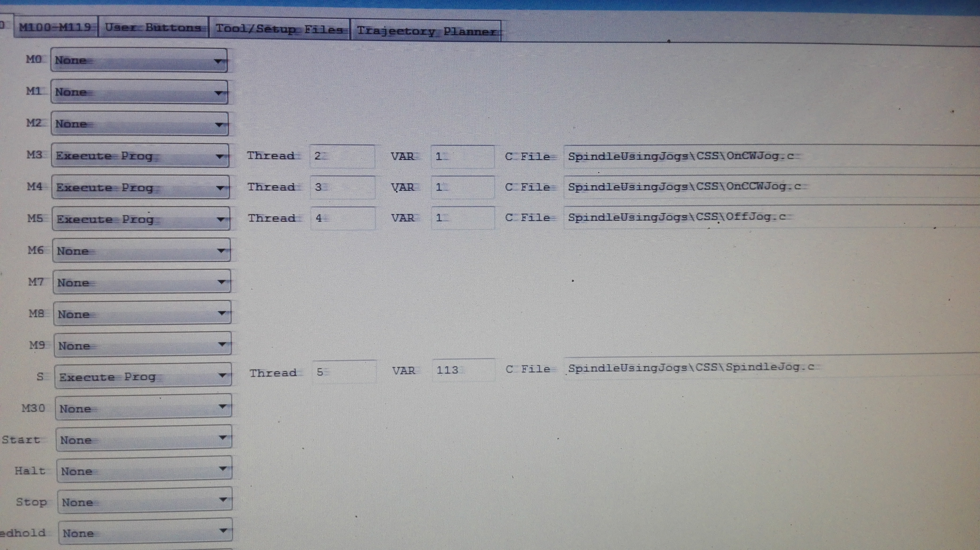

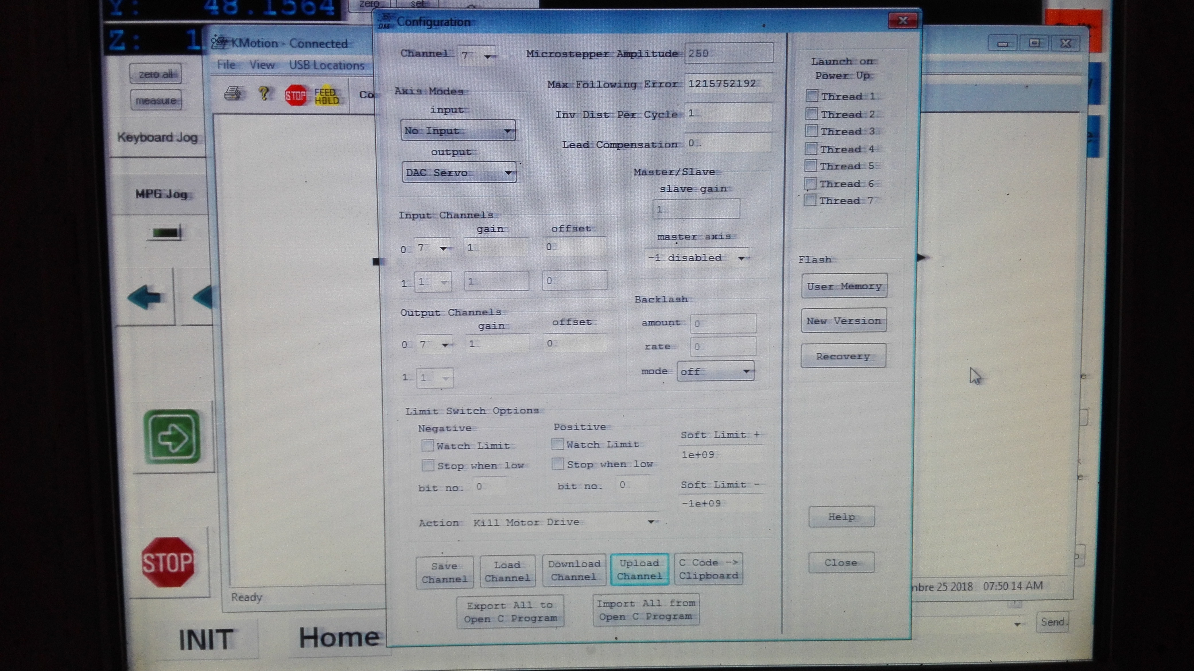

attached my setting files. Jog command doesn't change Spindle speed, S command in KmotionCnc change the jogging speed but the Dac has the same value.
Waiting your suggestion...
Beppe
Console and Analog status
Channel 7 configuration
S configuration in Tool setup

Re: S command doesn't work properly
Post by TomKerekes » Sat Apr 20, 2019 5:20 pm
Hi Beppe,
If Jogging Axis 7 doesn't move the Spindle then Axis 7 is not configured properly or Axis 7 is not enabled.
Is Axis #7 Enabled? Check the Axis Screen.
How is Axis #7 configured. See the Config/Flash, Step Response, and Filters Screen. It should be configured as described here.
Instead of photos of screens it is better to grab screen shots using Alt-PrintScreen, paste to paint.exe, crop, save as *.png file.

hi Tom,
in the Channel 7 configuration picture I sent before do you see something wrong? I uploaded from Kflop the configuration then I am sure about channel 7 status. In the picture below you can see that axis #7 is enabled. Did you ceck my C configuration files? It's all as requested?
Post by TomKerekes » Sat Apr 20, 2019 7:32 pm
Hi Beppe,
Axis #7 is not configured properly with regard to the Step Response Screen Parameters FF and PID. Please read the link in my last post.
