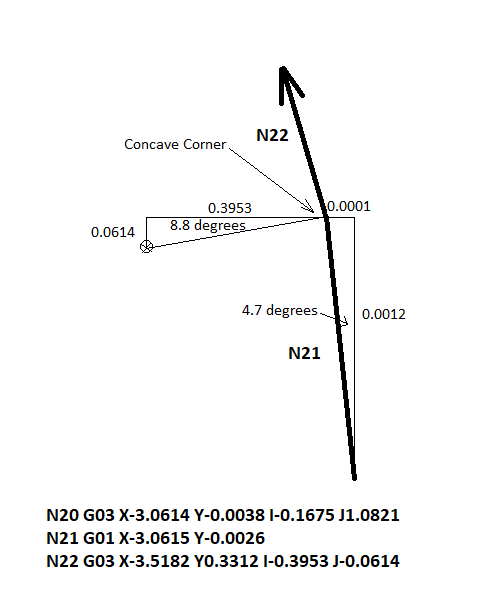

Hmmm. The GCode does in fact have a Concave Corner of 4.1 degrees:
KMotionCNC currently allows gouging by 0.005 radians (2.86 degrees).
I suspect the problem is caused by the microscopic ~ 0.001 inch long segment which has rounding issues as the coordinates are only specified to 4 digits. The NIST code has a historical reference to 0.01 radian limit which would probably allow this.
I wonder what the limit for Mach4 or Fanuc are?
I suppose we could make the threshold an option.
Or ignore angles of "tiny" line segments. But that might be dangerous and I can't think of an easy way in general to determine what size is significant.

Yes the rounding error of +/- 0.00005 inches on the endpoints of that 0.001 inch long segment will change its direction by a few degrees pretty much at random.
Can you change the Fusion post processor to output another digit of precision? It sounds silly but rounding to 0.0001 on tiny segments can cause a smooth path to become all zig-zaggy nasty.
