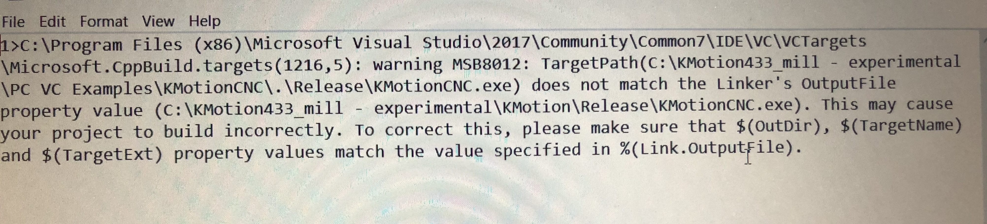

What is the ideal Visual studio to install ?
I had 2017. It did an import and had me add mfc 8.1
(probably) and rebuilt. There were some warnings but
no errors. It couldn’t find the exe to run and gave me
a long message about linker. I tried it with vs2015 but it also required an import of the project and it gave hundreds of errors.

The projects are compatible with VS2015 without any upgrading. See here.
Make sure you are using our latest Release Version 4.34
VS2017 should also work but when Microsoft upgrades the project the Target Directory is not maintained correctly. So you will need to correct this.

If you opened the solution/projects in 2017 then went back and tried to open/build in 2015 that is probably what is causing your build errors in 2015.
I'd suggest reinstalling to a new dir and building with 2015 again.
