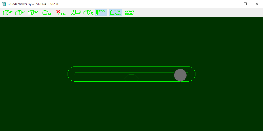

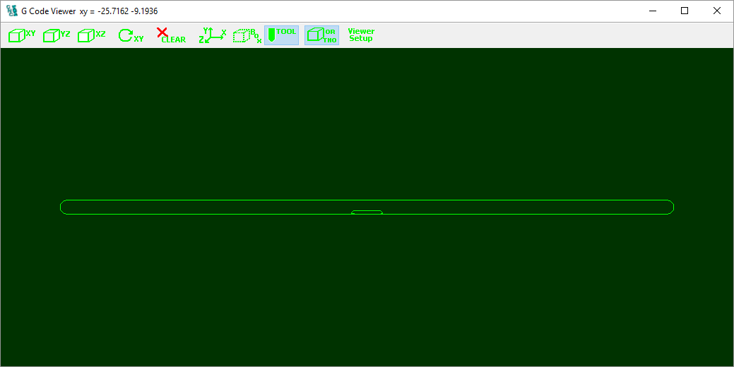

The radius compensation seems to work ok for me. Here is a tool path plot of your GCode with comp for a 5mm diameter Tool.
with comp.png (7.36 KiB) Viewed 15685 times
Here is a double plot with/without compensation. "Without" comp was created by setting the Tool diameter to 0.001mm (Tool image diameter is still 5mm)
I've also attached the Settings file (as a txt file) that was used.

It seems the specified paths in your GCode in both cases (with and without compensation) is exactly the same.
Maybe the confusion is that there are basically 2 approaches to Tool Diameter Compensation.
#1 - is where the GCode specifies the final result without any compensation at all. In this case the Tool Table entry contains the true Tool Diameter of the tool and the GCode Interpreter does all the compensation.
#2 - is where the CAM software does all the compensation and specifies in the GCode the tool path based on a theoretical tool diameter. In this case the Tool Table entry contains a small +/- difference between the actual tool diameter and the theoretical tool diameter used by the CAM. The GCode Interpreter then makes only a small adjustment to the tool path to compensate.
Do you understand the difference? Which approach are you intending to use?
Re: Fanuc Radius Compensation
Posted: Mon Sep 24, 2018 9:16 pm
by a_j_p
Hey Tom,
I was planning (at least in my head it seemed the easiest) to have the CAM software setup with the theoretical/nominal tool diameter and specify the end result. The Tool Table would contain the actual tool diameter and the GCode interpreter would offset itself half the distance of the diameter in the tool table to yield that end result.
If I understand what you have written correctly, I believe this would be your option #1.
Is that not what I am doing?
Again, thanks for the help!
