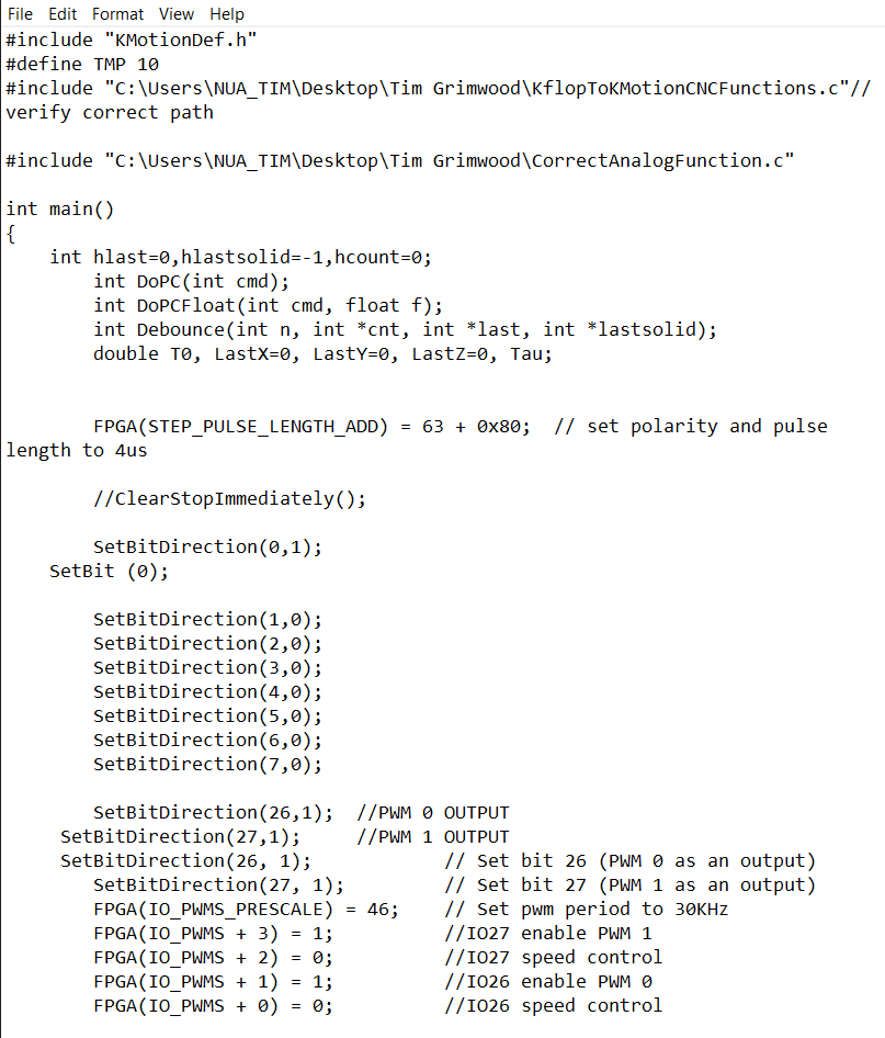

C Program Changes: Carl helped me load C program changes that should allow for spindle control via the KFLOP board, but I don't really understand enough here to know what my current set up is. We couldn't get it to work. I do recall seeing some code that was reminiscent of the SpindlePWM.c example code in the examples files though. I've attached a picture of the section that I believe was modified, though there may have been other code added elsewhere.
So far nothing has worked. I always attempt an M3 command with various speed commands (S12000, S16000, etc.) to test it each time and never get speed control. The first set of connections described resulted in the M3 command not working at all. When I changed it over to the VFD connections for source voltage described in the note above, the M3 commands worked again, but no spindle speed control. I plan to test it again with a higher input voltage when that power supply arrives to see if that could be the issues, however, I'm not sure I'm on the right track with that.

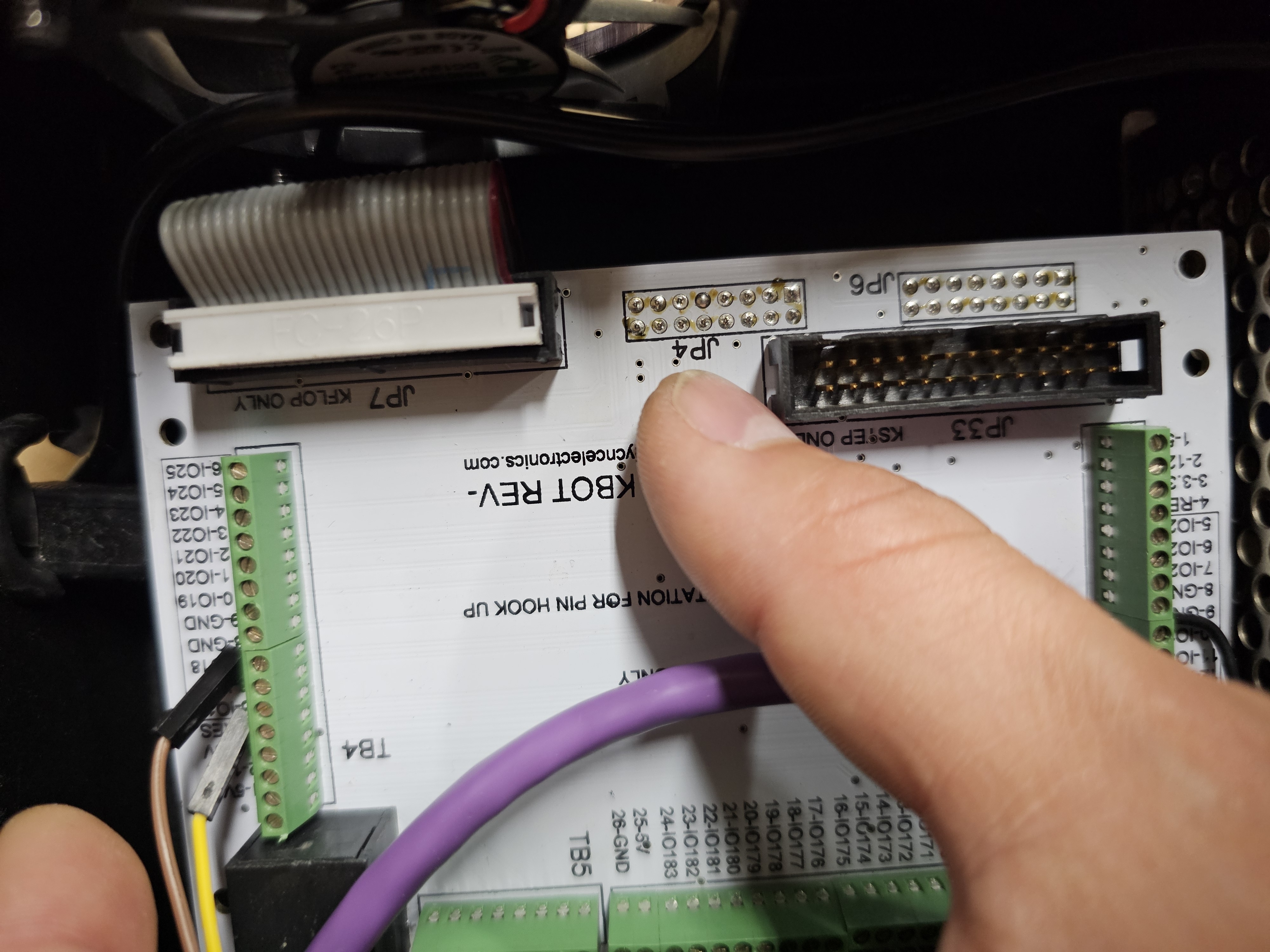

Really appreciate it! Just tried it exactly as you described and was able to get the control box set up in a way that I can have it out and read the pins directly on the board. Unfortunately, no voltage detected on the V-OUT and GND pins. I even tried reading the pins directly on the KFLOP board with no luck (though I'm not sure if a multimeter can detect PWM signals or not). I do see that the Digital I/O screen shows pin 26 blinking, so I tried changing the clock to 255 and that did register as a solid checkmark in the Digital I/O screen. I took a reading again on the converter board, but it still shows 0v.
I included a picture of my setup just in case it's helpful. I do have a unique breakout board that seems to be called the "KBOT," however I can't find any literature on it. It seems to offer simple pinouts for everything though. I've been connecting to "TB6," which looks to represent the JP6 header. I was able to read continuity between pins to confirm those pins do, in fact, represent pin 5 and 8 on the KFLOP.

The Digital IO Screen proves the software and PWM are working correctly. The Bit 26 checkbox is actually reading back the voltage on JP6 Pin5 so it is virtually certain that the PWM signal is actually on the pin. The KFLOP output pin is a 3.3V signal so when high should read around 3V and when low something like 0.1V. If you connect a DC Voltmeter to a switching signal what it reads can be indeterminate, but I think most meters will show the average voltage. But the first thing to test would be to set the PWM duty cycle to 255 (100% on). This will place the pin in a solid high state around 3V. With nothing connected to KFLOP use the multimeter to check JP6 pins 5 to 8. You should read 3V. Take care not to short pins with the meter probe or you may damage KFLOP. If you read 3V then repeat with it connected to your converter board and check pin 1 (DIN+) to pin2 (DIN-) at the converter board it also read around 3V. Make sure with the meter's red probe on pin1 and black on pin 2 the meter voltage is positive.
Your photo didn't show up.
I don't know anything about a KBOT board?

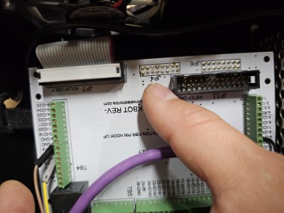

Oops, looks like the file size was too big. Tried making it a smaller image size, so hopefully that worked. I figured out part of the issue! This little breakout board is mislabeled. It mixed up the labelling for the JP4 and JP6 headers, so the pinouts for those are mislabeled as well. I was able to trace down which pins truly corresponded to pins 5 and 8 for JP6, and was able to read voltages that varied based upon the clock rate I uploaded via that C file. I put it all back together, but it still doesn't work yet. At least I know the signal is being converted to a steady voltage now. It put out 10.04 volts when clocked to 255, and 5.4v when clocked to 128. The voltage was positive on the converter board pins as well.TomKerekes wrote: ↑Tue Jul 22, 2025 8:15 pmHi Tim,
