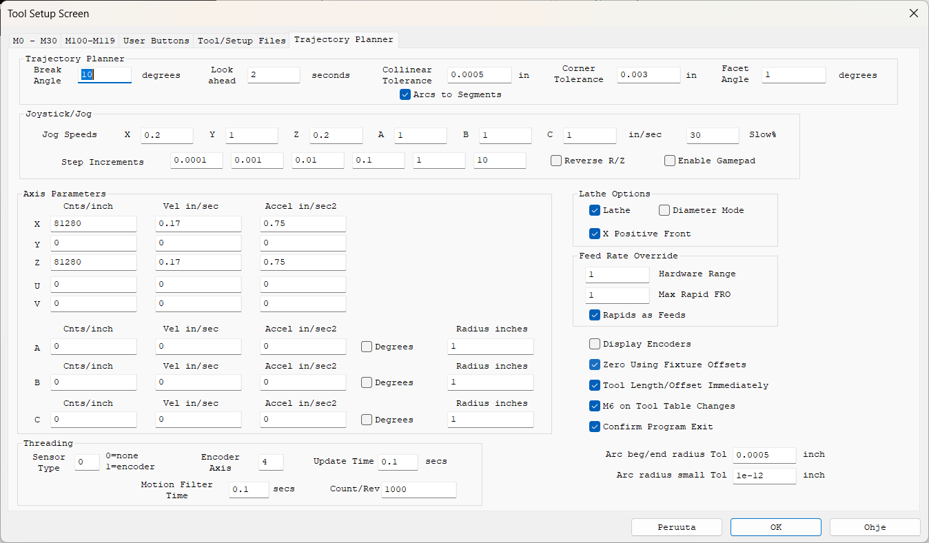

I have a problem that the rapid feed moves in KMotion CNC are not following the settings in the KMotion Step Response screen Velocity, Acceleration and Jerk. They are much faster and cause the steppers to stall. I've checked that the settings the settings are correctly downloaded to the Init.c program. I've as well checked the Trajectory planner settings in KMotionCNC. Tried to lower the rapid moves feedrate from the Trajectory planner as well, without any effect in the speeds.
Only way to change the G0 speed is to copy the KMotion Step Responce settings to the Trajectory planner max speeds (translated to inches/sec) and check the Rapids as Feeds check box.

I can't think of why that would be. What Version are you running? Please post your Initialization file and your Trajectory planner settings. Also the GCode that shows the problem. Are you executing the C Program? You might upload the settings from KFLOP to verify the settings are actually being set.
You should not need to select Rapids as Feeds if you don't have Kinematics.

Attached the Init-file (Reset_Sherline.c), the files linked to it (SherlineDef.h and ExtraButtons.c) and a screenshot of Trajectory planner screen.
Now the "Rapids as Feeds" is ticked. It was the only way to slow down the G0 moves: Nothing else was changed. (Today everything worked OK with this "Rapids as Feeds" setting.) So basically for the moment I'm ok. But somewhere something is not quite right...

I can't duplicate the problem with those settings.
If I code
G0 X100
M30
I see a feedrate of 10.3 inches/minute which seems correct. Also if I double the KFLOP Velocity to 28000 steps/sec the feedrate doubles to 20.6 inches/minute.
What are you doing and seeing?
One issue is the Cnts/inch of unused axes are set to 0. Please set to non zero values such as 100 to avoid divides by 0.
