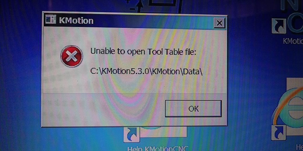

I'm finishing setting up the milling machine. I have completed the spindle operation programs in order to stop the axes and wait for acceleration / deceleration of the spindle. And I've already tested it through MDI. Everything worked fine.
Suddenly KmotionCNC froze, after which the PC started to reboot. After the reboot, the following messages appeared :
Windows 7 32
For some unknown reason, these files turned out to be empty. And KmotionCNC has reset all settings.
I have two questions:
1. Why could this happen?
2. How to save and restore KmotionCNC settings correctly? From where and which files should I save?
P.s. All my custom .c and .out files have not changed and are correct.
Windows 7 32

The KMotionCNC Configuration is stored in \KMotion\Data\GCodeConfigCNC.txt. Later Versions maintain a copy in \KMotion\Data\GCodeConfigCNC.txt.bak which should be used automatically if the other is found to be corrupted. What Version of KMotion are you using?
Hard to say what was the cause for Windows to crash. If Windows is not shut down properly then disk files can be corrupted. More likely disk files recently written.
It's a good idea to backup the \KMotion\Data folder (or entire installation folder) periodically.
Sorry to hear this.

Copy the entire contents of the \KMotion\Data folder. See also here.

Files GCodeConfigCNC.txt and GCodeConfigCNC.txt.bak are identical and match the default settings. My KMotionCNC settings are lost.
Why are my settings not saved in the GCodeConfigCNC.txt.bak file? What is my mistake?
- Posts: 2931
Re: Loss of Kmotion and KmotionCNC files during operation.
I'm not sure how the files got corrupted. If you answered Yes to the
"Continuing will cause a loss of all settings. Are you sure you would like to continue?"
then the parameters would be set to Default. But that doesn't explain how the files got lost/corrupted in the first place.
I suppose the mistake was to not back up the files.

Whenever KMotionCNC exits it saves GCodeConfigCNC.txt and GCodeConfigCNC.txt.bak with the current settings.
