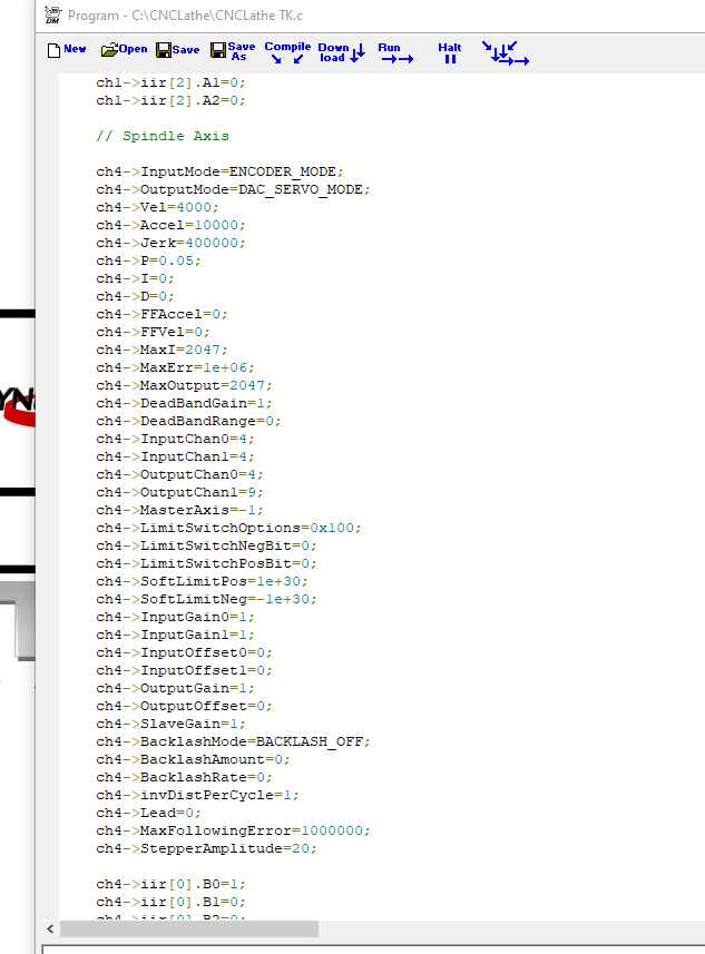

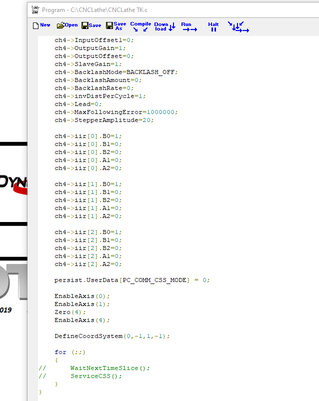

Ok Tom I tried the jog input you suggested and get no response. I can use dac commands, but not jog. There is another interesting issue that is present and it afflicts my other lathe as well. As soon as the kmotion screen is initialized the spindle tries to take off to full tilt. The big late just trips out because there is not enough power for it to accelerate up fast. The way my small lathe acts is that it accelerates to a very high rpm in one direction, then slows to a stop and accelerates in the other. This continues on for a few cycles back and forth getting less wild with each wind up. It finally settles down to 0 speed and is then fine for as long as I run the lathe for that session. I have included shots of the C program for your reference.

Please post the C Program code rather than screen shots.

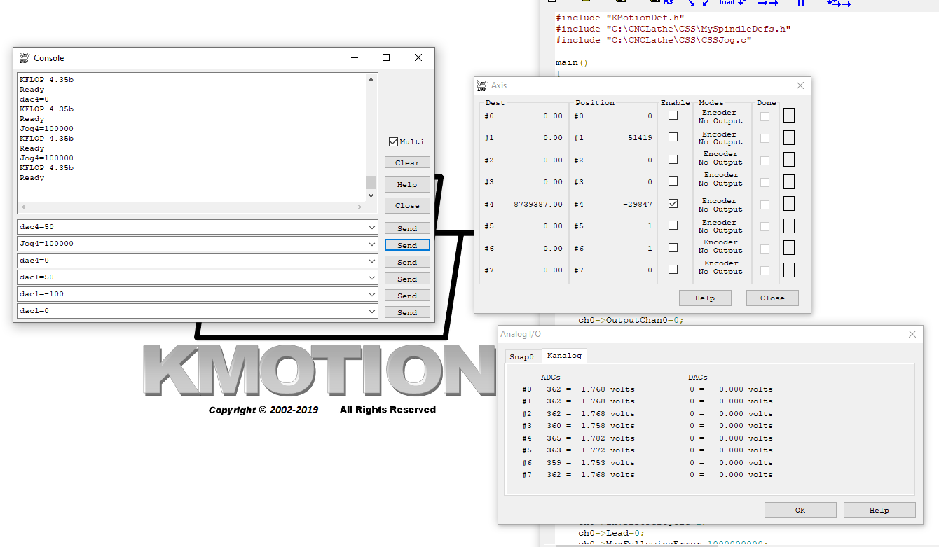

There is no response of movement for the spindle with jog command. The console shows no error message ( see picture). Dac commands still work,
but not jog. I do not know what you mean by show C program code. Is this under the sub program - spindle jog or?

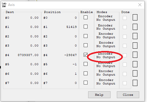

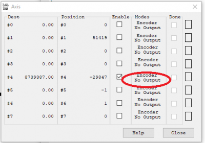

It seems KFLOP is not initialized.
In fact none of the Axes are configured. Seems the CNCLathe TK.c program was never executed. You need to Initialize the system before anything will work. But it isn't clear how Axis #4 was enabled.

I meant to attach the Init Program CNCLathe TK.c rather than taking screen shots of pieces of it as a photo. You can also include it it the Post as with Code Tags using the </> Button.I do not know what you mean by show C program code.

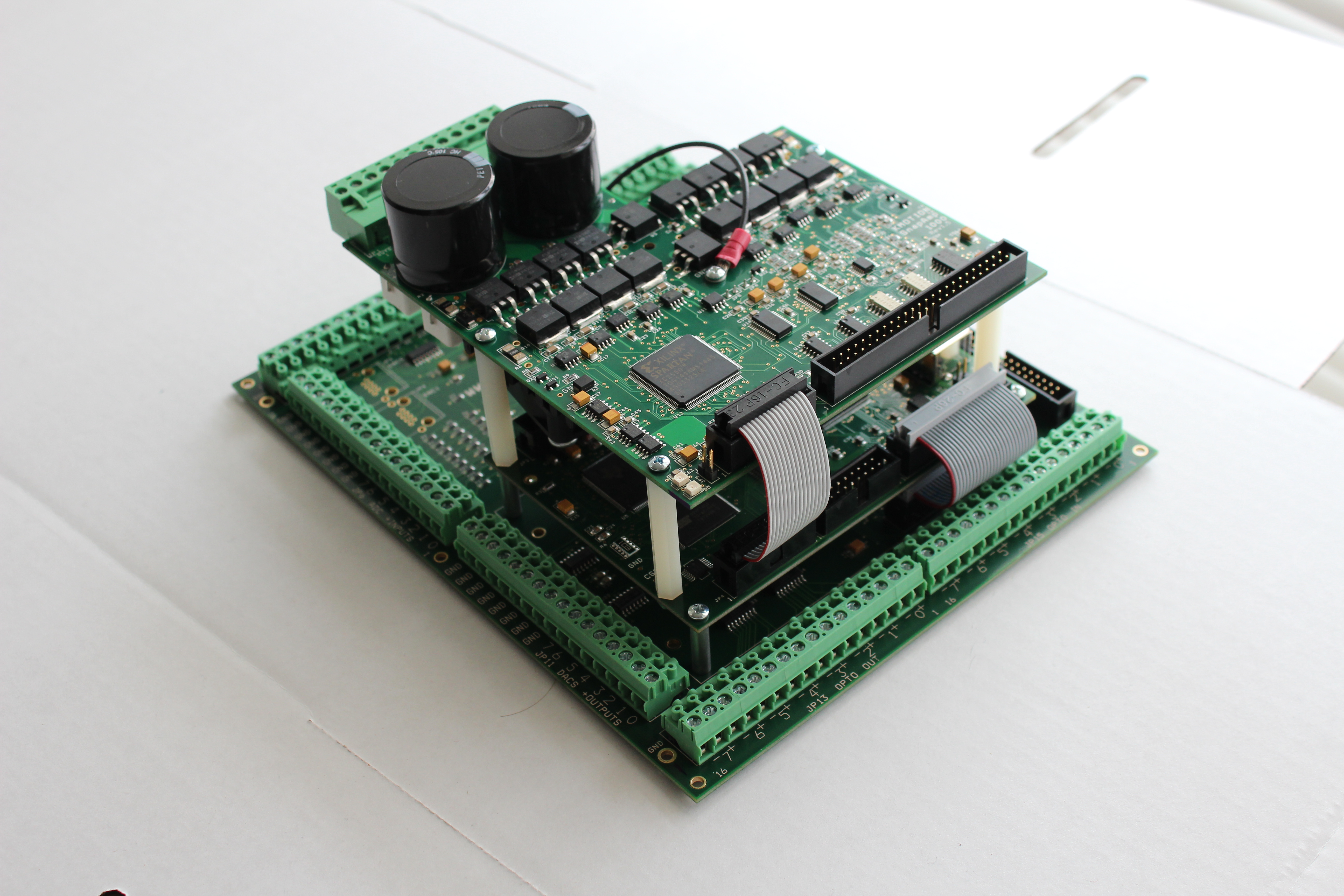

This is how we recommend mounting:
No1. Do I have to move the encoder inputs from the kanalog to the snap amp?
No. I believe you have DC Motors with Brushes so the output Type will be "DC Servo"3 Will the current assignments set up for the X axis be able to stay the same as they are set up now?
if you wish4 Since I need to connect with you again for final commisioning, can you do the set up?
Sorry I forgot to tell shipping that you have a Kanalog with the SnapAmp. We can send you a longer cable or you can make one yourself.5 The info on your site indicates the data cable should be as short as possibe. Do you offer a little longer cable than the one supplied with the snap amp? Neither of the cables that come with are long enough to reach the kflop after mounting all up. This is partly due to the supplied standoffs are not long enough to allow the fan on the back to clear the data jack on kanalog, so had to add a set of the short alum spacers after making all thread out of 4-40 screws.
